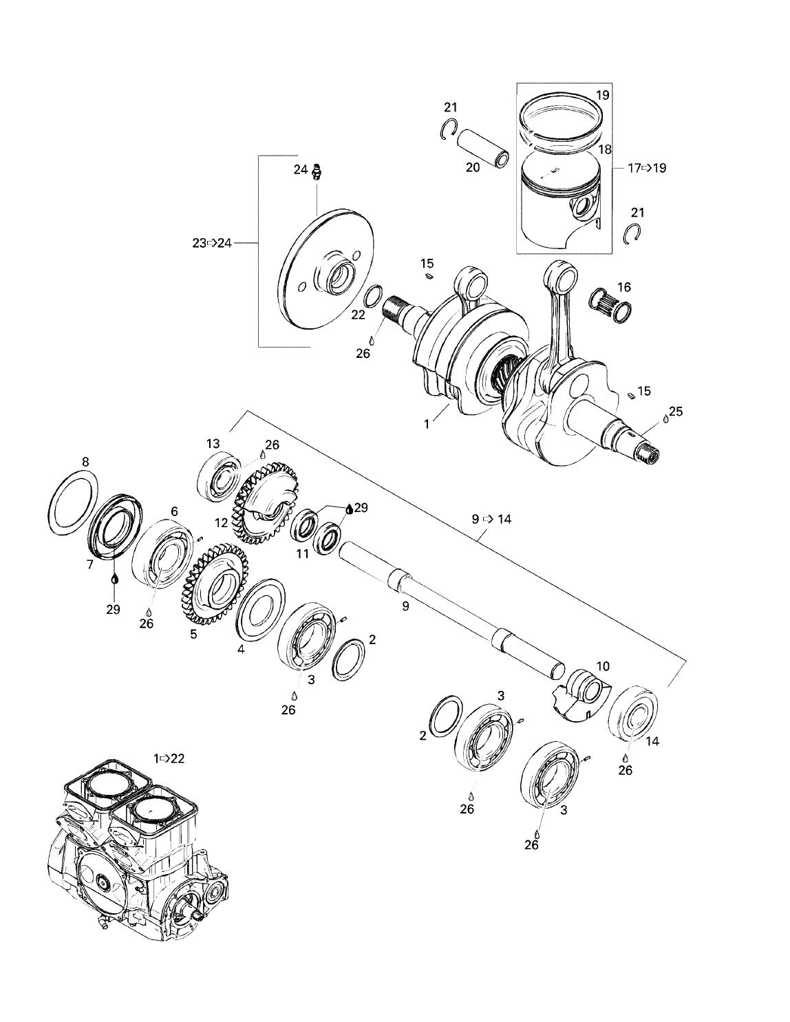

Under products choose boats, then 1997 then your model then crankshaft and pistons and you will find the PTO
PTO part#290958056
