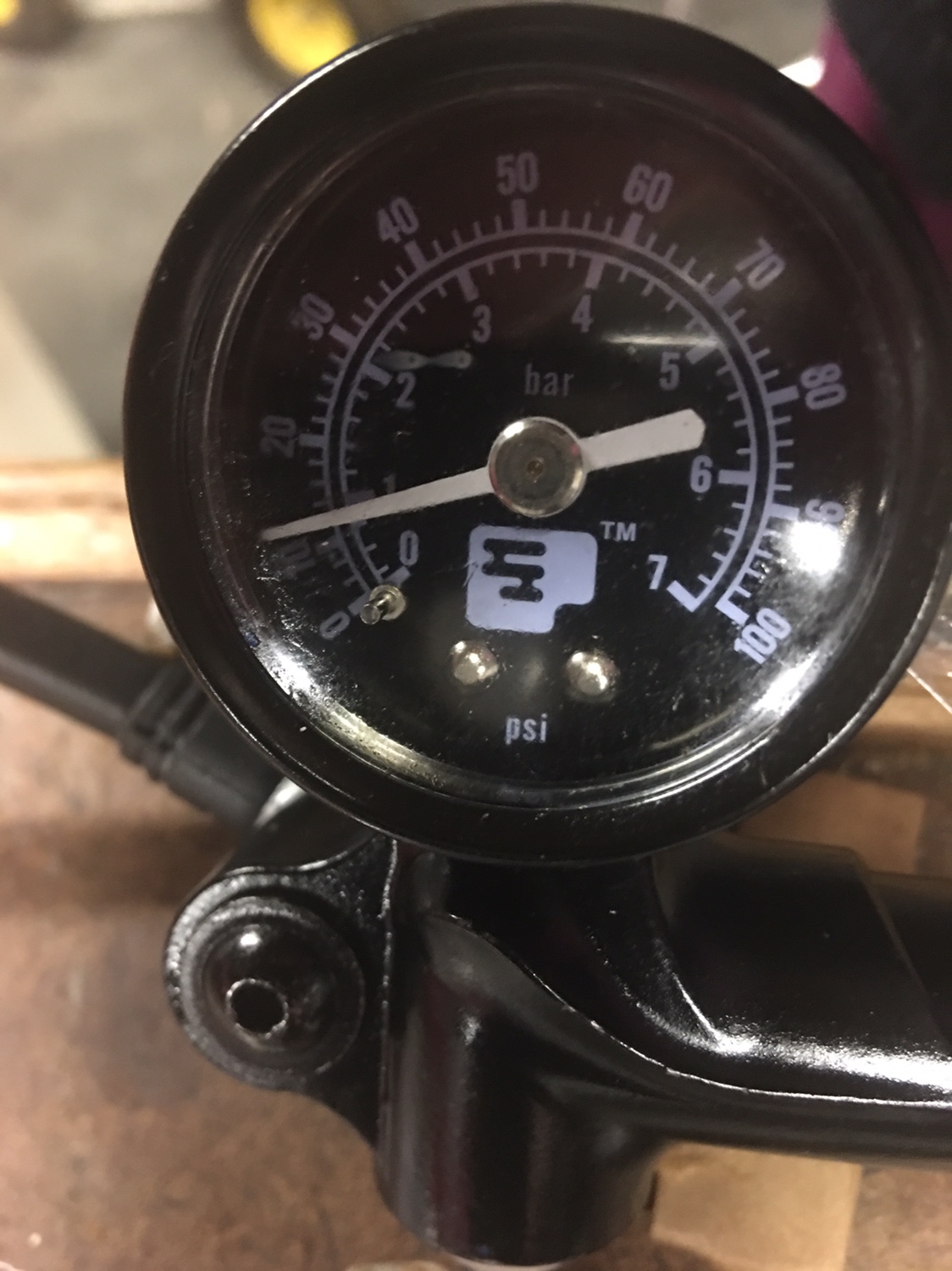

Fuel tank vent valve is good. There is blow by coming through carb throats and will actually lift the arrestor grill upward. I bought this ski and trailer for $200, for the shorelander trailer. PO said motor was locked up and gave me the ski. After I pulled the pump, checked pistons/cylinders I found that he had dropped an carb arrestor bolt down the intake bending the rotary valve and making one fairly deep gouge on the engine side faceplate. I replaced the rotary valve and hoped there would be no problem. Guess I’m gonna have to get a new lower end and rebuild the motor or fine a good used donor engine.
