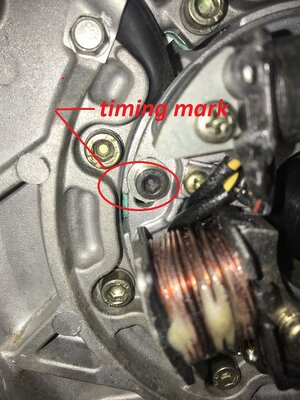

M Mem1guy Premium Member Premium Member Mar 13, 2023 #26 That’s why I was questioning about the marks. The other mark is visible once you remove that bolt and washer.

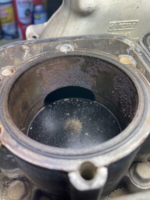

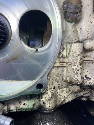

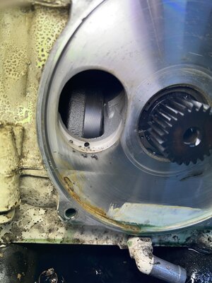

M Mem1guy Premium Member Premium Member Mar 13, 2023 #27 Alright, I got her opened up but haven’t pulled crank out of case yet to check bearings but here are some pics. Let me know what y’all think. Attachments 7F41184E-67D0-4338-B7DB-BCF1B8FFFF7D.jpeg 270.7 KB · Views: 8 8106564E-992B-469C-A928-FEAB9AF81F0C.jpeg 318 KB · Views: 9 81274E82-3976-4BEA-B831-03286EFA97EE.jpeg 319.7 KB · Views: 9 5663CBB0-115D-4793-B644-F89B4DAB94CC.jpeg 348.9 KB · Views: 9
etemplet Premium Member Premium Member Mar 13, 2023 #28 SIMPLEARKANSAN said: I have a dumb question, but what is that mark lining up with? Click to expand... Under the washer of the bolt.

mikidymac Moderator Staff member Moderator Mar 14, 2023 #29 SIMPLEARKANSAN said: I have a dumb question, but what is that mark lining up with? Click to expand... There is a mark on the stator and one on the block. You can't see the one on the block because it is under the washer. But the big warning is not all have the mark so check under the washer before you remove the other bold and mark it yourself it it is not there.
