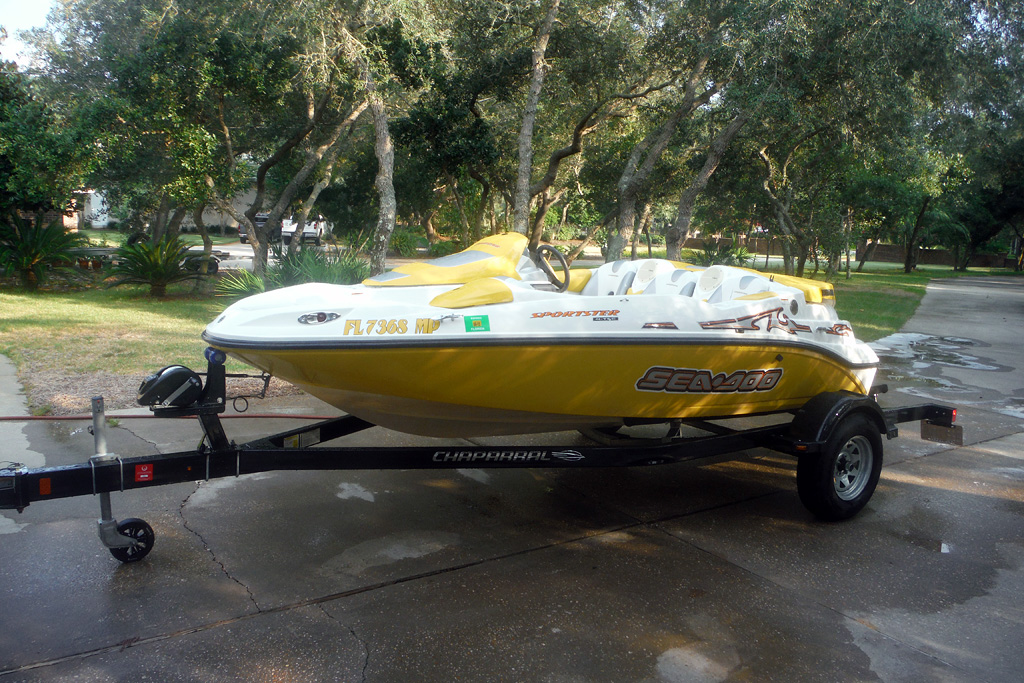

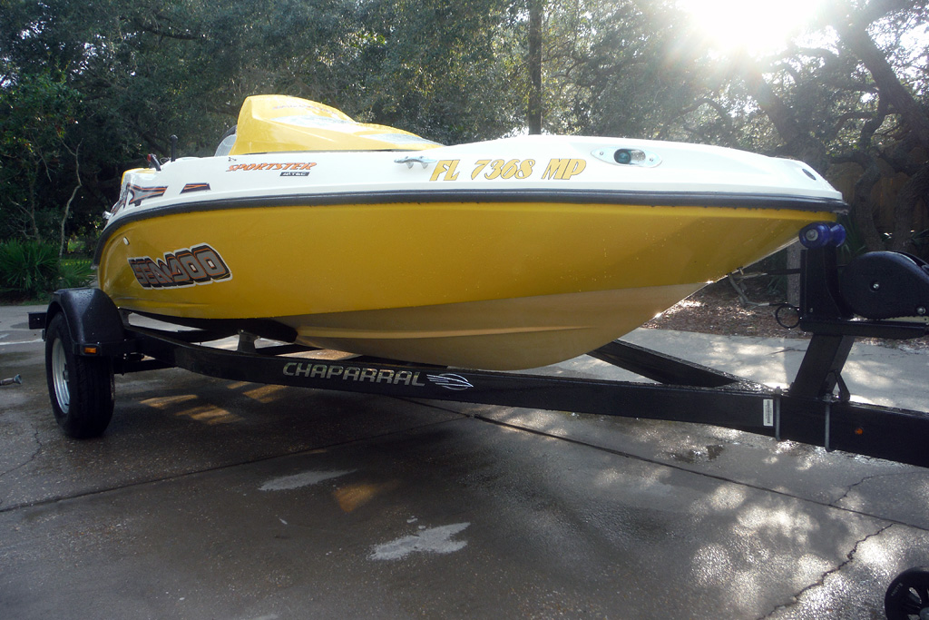

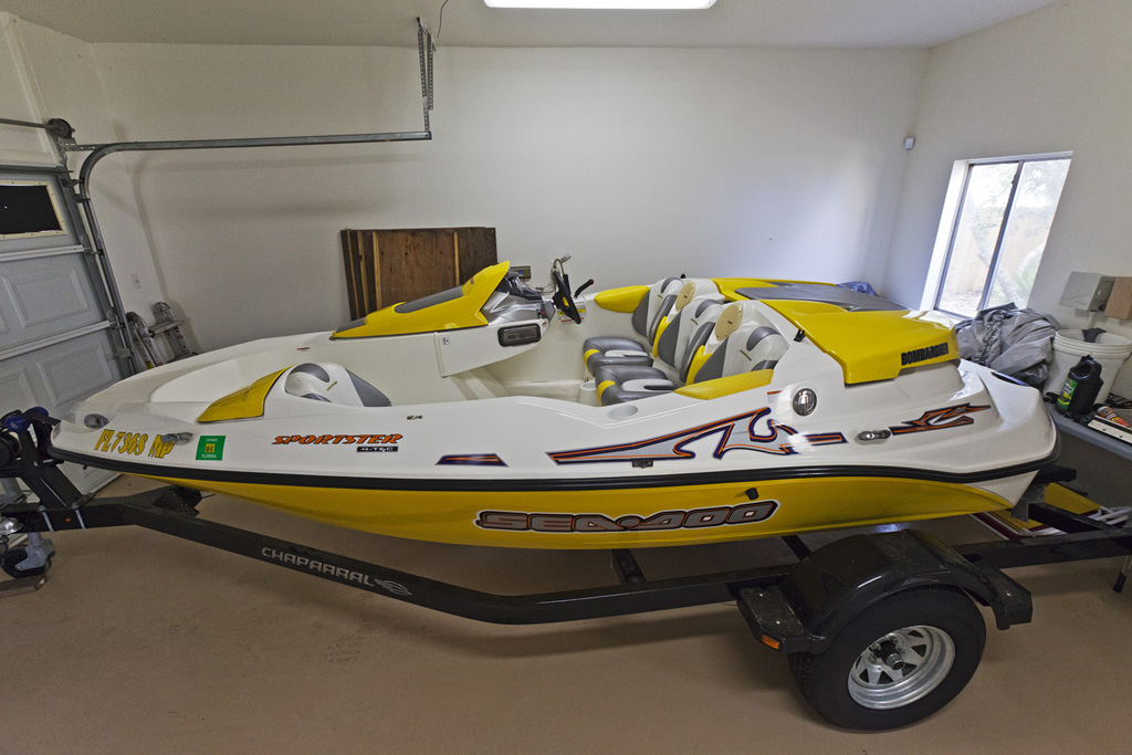

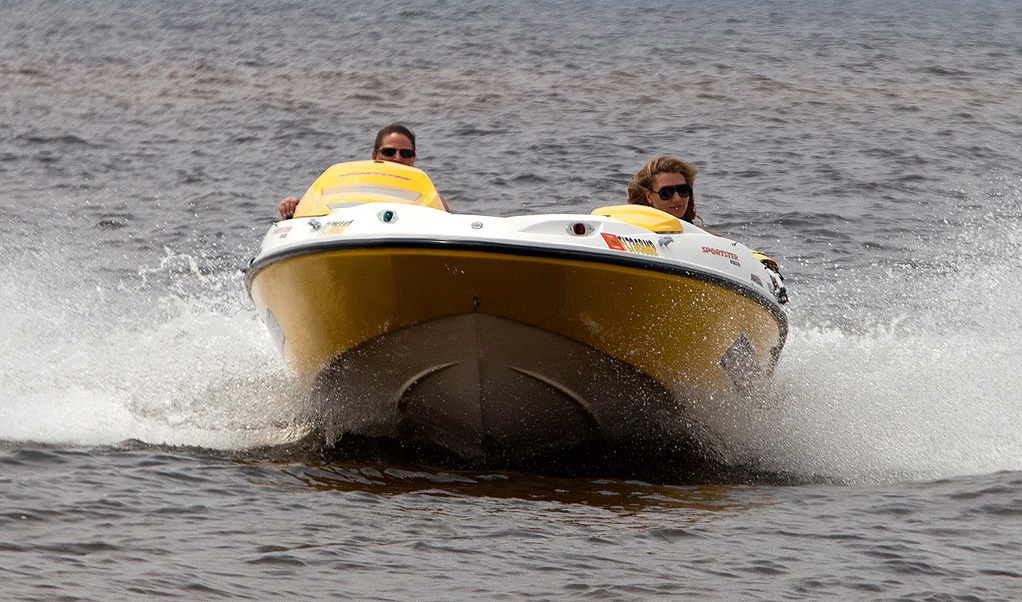

What's up guys, new member here, lurker since June, new owner of an 04 Sportster:
We picked it up right before Memorial Day Weekend, and it's been a blast. It was traded to a local boat dealer that inspected, serviced, fixed and flipped it, and we were lucky enough to be the first to respond to the advertisement. I want to thank the participants of this forum for its awesome content as the information here is absolutely invaluable to a new owner like myself.
We've put about 50 hours on it and so far, so good. The engine runs strong and everything seems to work, and most importantly this boat is a blast. It's fast enough for us, and certainly fast enough for its size and for use on the bay on which we live. We recently rescued a dog who turned out to be a heck of a swimmer, and who loves heading out on the boat every chance he gets.

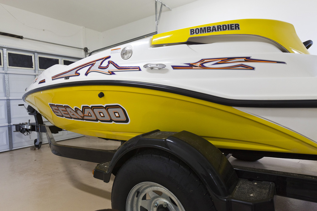

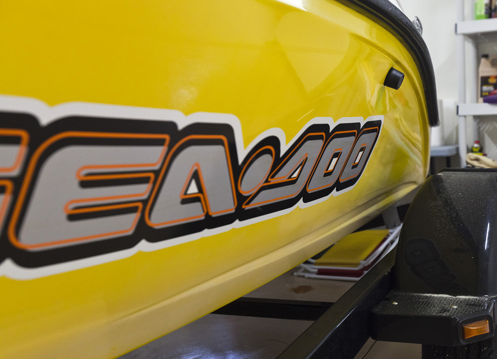

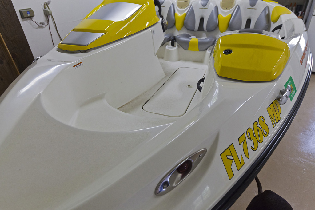

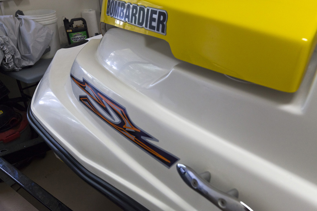

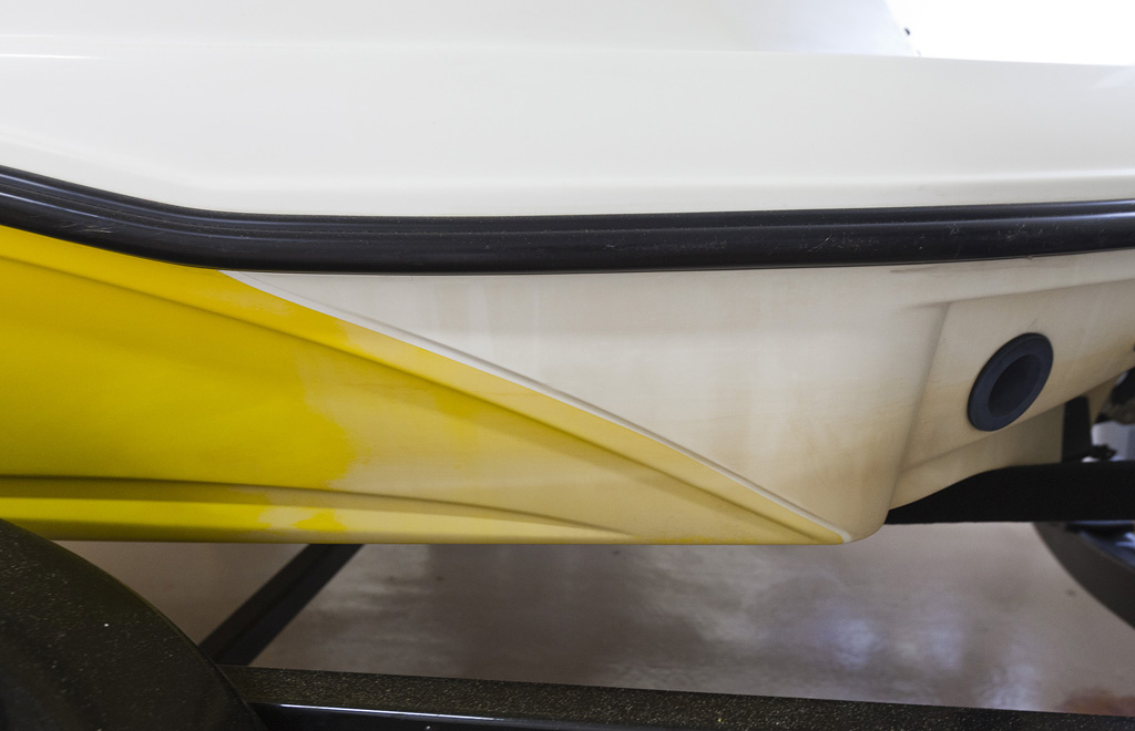

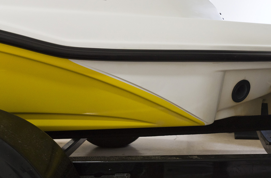

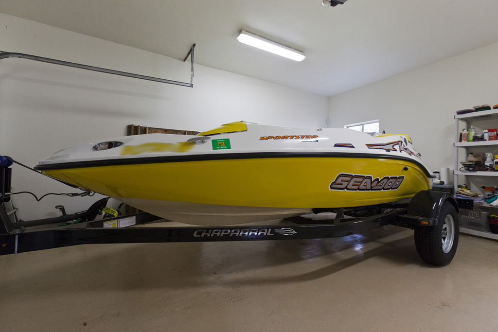

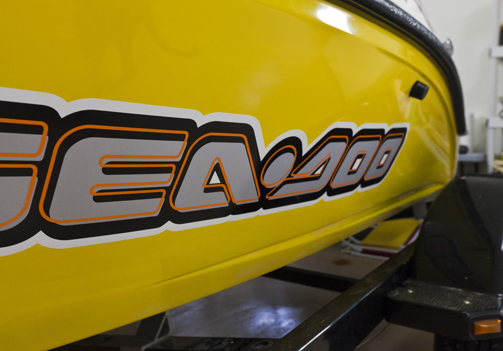

This weekend, after some good forum research, I tore into the gelcoat a bit to try and brighten things up. It all began on Friday when the new registration stickers came in and I used a buffer to help get rid of the ghosting from the old stuff - The two parts I buffed ended up being so much whiter and brighter than the rest of the boat that I had to continue buffing the entire top area above the black trim, but ultimately the pad/product combo I used did not provide enough cut and left things a bit splotchy and uneven in places.
I went back at it today with 3M Super Duty Compound, which yielded great results, and then followed up with Meguiar's 205 and topped with an ample amount of Collinite 845. While I suspect some spots will likely only benefit from wet sanding, I'm still pretty happy with the final results.
Some before and afters:
Finished:
