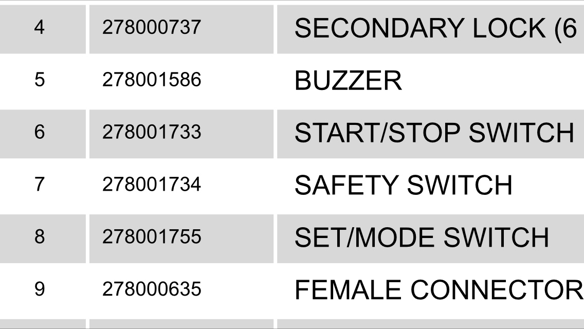

So i figured it out that the actual switch is good, its the Actuall RED START/STOP Button, the plastic piece that is sticking, do you happen to know the part number for just it, and not the actual switch (278001733). thanks
