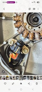

Ski ran fine until a bent rod forced and engine rebuild, ended up finding a crank in my area with good bearings and swapped out everything. After reinstalling the motor i found no spark.
ALL WIRING IN E-BOX
TESTED POSITIVE
MPEM
TESTED POSITIVE
PICK UP STATIC TEST (NEW DURING REBUILD STILL CHECKED)
POSITIVE
PICKUP DYNAMIC TEST
FAIL
From what i can't tell the mag cup with the bulges for spark are not in proper alignment of the pick up. Is there two different lengths of crank shaft between years or am I not getting the fly wheel to seat far enough for the connection to complete.
