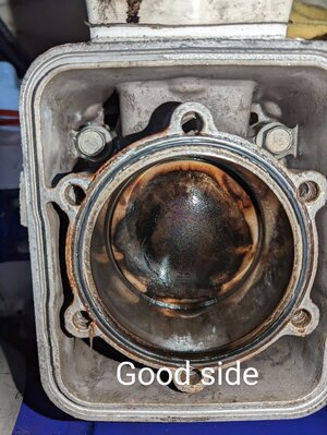

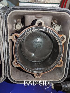

Hey guys. Bought 1996 Seadoo GTX 787 last year from guy who had a brand new BRP motor put in....right from dealership. Anyway his blew the pump side cylinder. I got it and had pump side cylinder and piston redone properly(clearances to spec by machine shop etc), redid fuel lines(he had old ones), complete official mikuni carb kits as he used aftermarket stuff, and she was alive and well again. The new cylinder and new piston was about 15 psi lower than the other side last year but ran great. I assumed it needed time to seat. Thought i would check it again this year and its 40 psi lower than the other side. Keep running or what? The chocolate brown picture of plug is the good untouched cylinder, the other is the cylinder rebuilt last by year.

No, at 40 psi difference you have a problem, no question.
Typically this is fuel system related but since you covered everything I would be looking at air leaks and the oil supply for the bad cylinder. When you put the engine back together make sure you pressure test it to check for air leaks and make sure oil is flowing from the pump to the bad cylinder intake fitting.

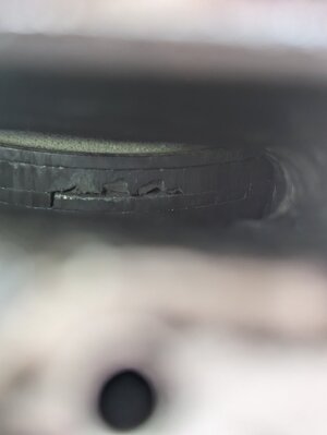

Took the power valve out and took a peek at the side of the piston... That's definitely not good what the frick.... Brand new piston. I'll do what suggested in terms of checking the oil flow to that cylinder and pressure testing. Unless this picture gives somebody a for sure idea of what's going on let me know, if not we'll report back after rebuild. Thanks!

Not good, lack of fuel or oil or the machined tolerances were not correct.

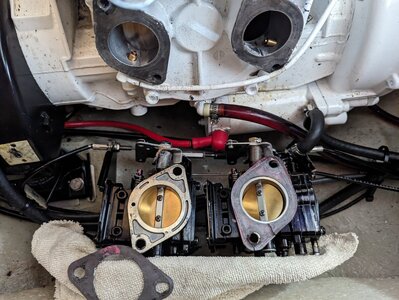

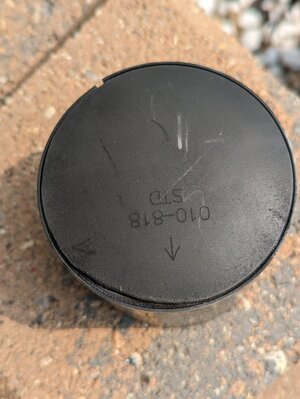

Just started digging into it.. found one of my carburetor to block gaskets laying in the bottom of the Sea-Doo must have fell off when I did the carbs last year... To clarify, the side that burnt down DIDN'T have a carb base gasket on it. Could that be enough to lean it out? Just about to start checking oil pump but found that and thought it could be the culprit...

So the previous owner had a new crate motor put in and rebuilt the carbs at the same time with jobber carb kit? Did he then loose a cylinder again after putting the crate motor in? You put 1 new piston in when you got the machine and rebuilt the carburetor with Mikuni parts? Sorry just having trouble following the chain of events, is that the first or second time since the new crate motor that the pto piston has melted down?. I would think the missing gasket in the carb would cause a lean condition but very odd that it’s the piston that had the gasket that burned down, . Was a new cylinder sleeve put in and bored to stock size when you had the one piston replaced? Or was it just a new piston put into the existing cylinder with no machine? Maybe Mikidymac can advise but I would think it would be a bad idea to replace only 1 piston? Being as how it’s only the 1 cylinder that’s melting down, I would do a leak down test and see if maybe the engine is sucking air in the oil seal, also maybe try rebuilding that carburetor again and make sure high and low speed screws are set to factory specs. How does the crank feel? I’m not sure but I would think if it was a lack of oil the crank would have suffered damage as well, and not just the piston. More like a lean condition than lack of oil.

Sorry I might have to correct that it's the side that didn't have a gasket... Was running awesome at all RPM from what I could tell.

Sorry correction the side that melted down did NOT have the gasket. I MISSED THAT MY APOLOGIES
Ahhh, that sucks, but makes sense. That was the problem then. The reason I was asking about rpm’s is because if it is sucking air the rpms would be high and you can lower them by choking the air from it. If that’s the case stop driving. Think you’re going to fix it?

Yes, you 100% for sure found the cause. Not having the gasket, that cylinder was running lean from the air leak.
