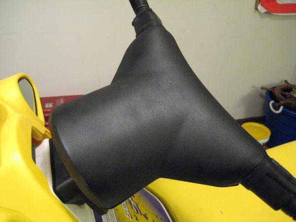

Everything seems good so far. I went with the spray on Plasti Dip and I was able to get a finish that looks very similar to the original; but in mildew obscuring black instead of yellow. There's no feelings of stickiness to the cover anymore and the finish feels sturdy. I'll try to post an after-season report on how it holds up to a summer of water and sun.

I left it on the seadoo and simply masked around the handles and covered the rest of the seadoo in a tarp to prevent overspray. I sprayed on three coats a couple of hours apart and let it cure for around 2 days. 1 can will probably take care of two skis; but I'd go ahead and pick up two just in case. I also recommend going with a dark color so that it covers up any old stains and is too dark to show any possible new ones.

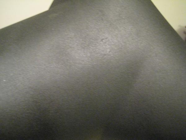

My covers have "smudges" or small gouges where the sticky crap smudged if that makes sense. It isnt entirely smooth.
Did yours have similar marks or was yours smooth? Because yours looks great now.
Yeah, if you look to the upper right of center on my close up picture, you can see the smudging/gouging. It was only a small one, but it's there.
