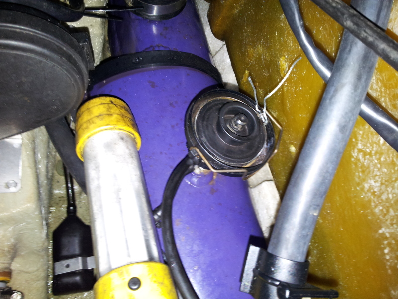

What keeps it clamped? Looking at the parts fiche I can't even tell which clamp it is.
How in the hell does this thing fit back on there?
Only way I can get that clamp in there is by picking up the rave some. Is that clamp in there to keep the rave somewhat open? I don't see how that thing fits in there.

what is the wire in the pic? try moving the clamp to somewhere it will fit under the cap. a lot of the bolts and nuts end up rolling around in the bottom of the housing. thats where i found mine when i bought the ski.
I have the wire there to help so I have something to grab onto. Also if I was able to get it on was going to tie it up with that. The bolt would have to be microscopic to fit through there.
Yes the bolt is very small.
When i took my complete valve off the bolt was laying inside.
When you unscrew it from the tank keep it upright until you are over a table then turn it over and see if its inside.
If you can't find the bolt a plastic zip tie will hold you over until you can get another band.
