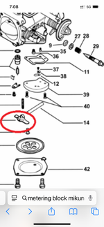

I went to this link and see the 95 models and down in that section mine looks like either one of the two on the left side. Its out at the lake so I can't quickly check it. It has twin carbs as well. I'm thinking it has the 587 but I want to make sure. Is there anything else I can do without having the machine here?
These are the carbs that I need kits for. thanks
What colour is the hull below the rub rail, and above? On the magneto cover there should be a tag that will tell you what engine, but again you don’t have the machine so can’t do that.
