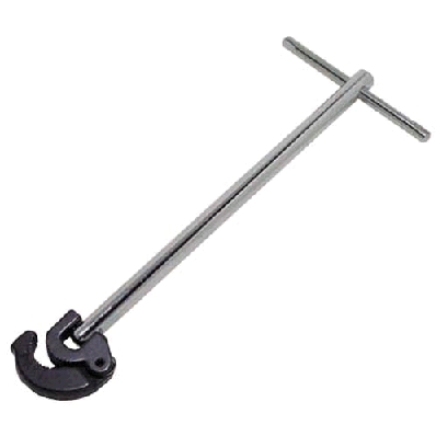

I tried taking the pump off but I cant break the bolts lose....grrrrr so I think I am going to pick up a Basin Wrench up. You think this will do any good?
The pump should be easy to remove. Just the four nuts with washers holding it on and the reverse cable, steering cable and OPAS connection then it should be free to come out.
