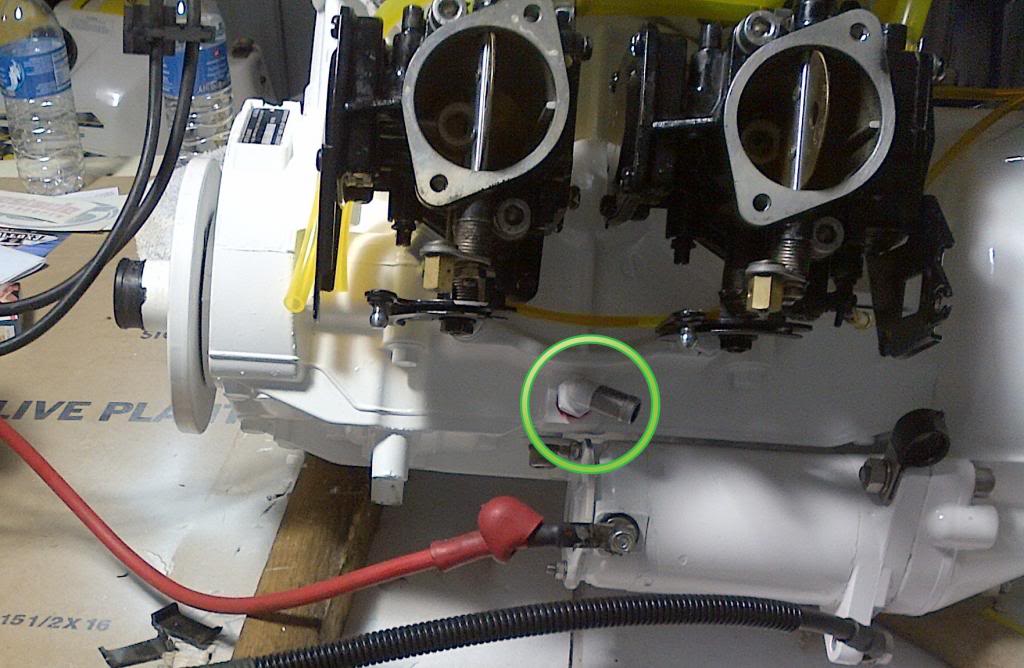

I'll assume this is a 787? If so, all mine have ever been are socket head cap screws (Allen screw) and they're from the front. The to one had a nut that has to be removed first. The only hex on the starter is the one for the ground cable on the ear of the starter with a star washer. On the back of the starter there is a third mounting screw, also a socket head cap screw. All of these should be visible with a mirror. If you haven't removed the air box yet you're just compounding your stress level. You can kinda see it here in kickers pic.

Ok...I've got 3 bolts from the front of the starter out and 1 bold from some mounting bracket that went into the engine. This starter just will not move. Am I missing something?
There are two bolts that go through the starter into the MAG cover and one on the tail of the starter that goes into the bottom of the cases. Once those are out it is just an o-ring on the front of the starter that seals to the cases and will pull straight out to the back.
I've hit it, pushed it, pulled it, pried it...doesn't even hint at moving. I pulled 2 bolts from the front that were mounting bolts, 1 from the front where the ground connected, and 1 at the rear that secured the mounting bracket up into the engine case for a total of 4 all together.
