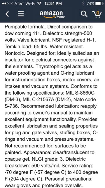

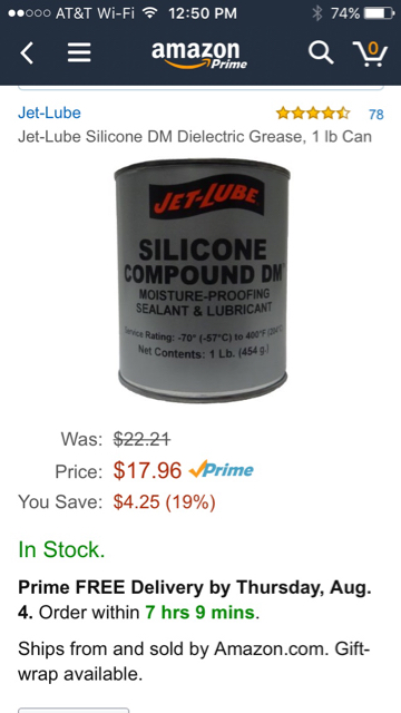

I found this stuff on Amazon last year:
You can see by the description that it is a direct replacement for Dow 111 and, because there is no metallic content, is also di-electric.
