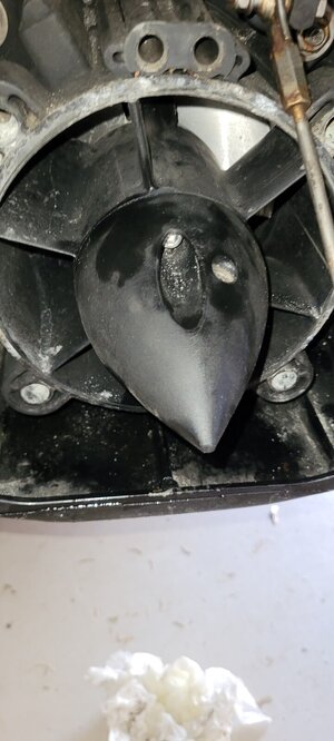

But it have a loud noise from jet area on idle,can sombody tell me whats this is?
The anti-rattle kit doesn't always solve the problem. It is just the way these pumps are, they rattle at idle out of the water and sometimes even in the water.
Ok,so this is normal on idle out of the water? Yes I have taking out the steering nozzle,for a better look inside.
Yes, they rattle and make lots of noise out of the water, everyone thinks something is damaged but it's just a Seadoo.
Mine was improved by adding the rubber bumpers at the ends of the drive shaft. I had forgotten to put them back on when engine was rebuilt. Still rattles… but much less.

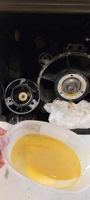

Thanks for answer 😊 I removed the hub in the jetpump to check the bearings innside. It was full of yellowish thin grease, maybe water in it? Can I use the grease on picthure?
Do you mean you removed the cone? Better hold off until someone answers, as far as I’m aware they take jet pump oil from brp or I believe 75w90 GL5 polyolester as an alternative but best to check your manual for your model
Kinda Strange coloration. You have to know what it looked like BEFORE it was added. LOL I'm used to seeing darkened oil or sometimes MILKY. Yours still looks clear. I'd lean toward leaving everything as is and replace the oil. If you believe water got in there then the proper response would be to replace the seal on the impeller side. Ski sounds OK to me. :)
Yes
manual will tell how much
When filling from the rear plug, the oil needs time to ‘seep’ past the rear needle bearing to fill the entire cavity.
manual will also talk about pressure testing (seal, cone O ring)
