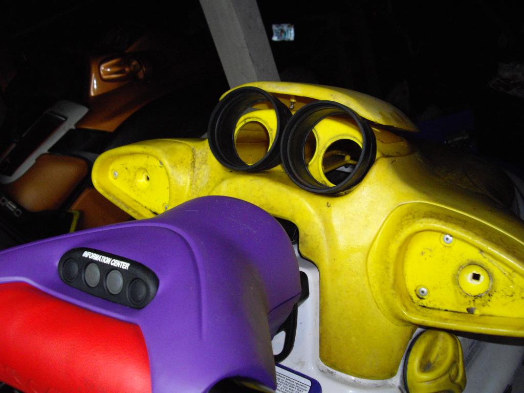

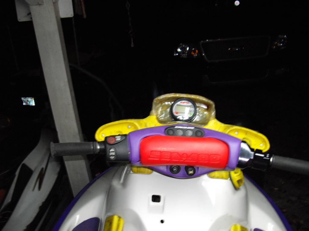

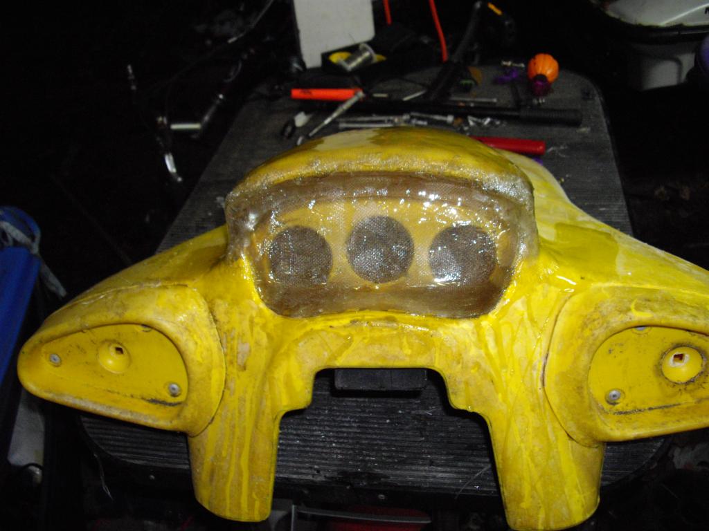

Yes, you read that correctly. I saw a 951 X4 build on HulkGreen :lol: and because I can't leave well enough alone, I want to do some gauge swapping in my 96 XP since I already have all the parts laying around. I want to use this thread to host all questions and hopefully document the build. My first question is electronics compatibility: I have a 96 GSX Info and Tach gauges and a 96 GTX MPEM- any reason why that combo wouldn't play well together? I vaguely remember something on a 96 GSX being rare/ quirky, but I can't remember what.
Here are pictures from the build I was referring to:
I plan on making both gauges fit in that area and hopefully blending them in a little better (not to knock that guys work in any way). What say you SDF folks?
