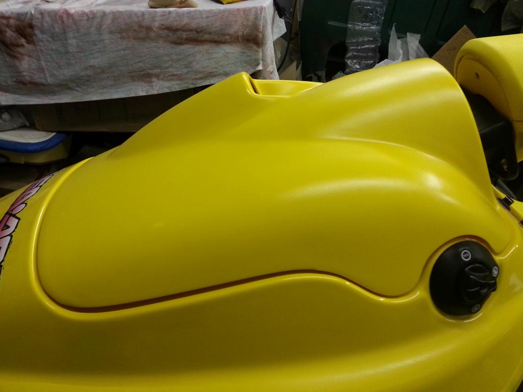

This used to be faded yellow. I used a scotch brite pad and a Soft Scrub with bleach. The washed it really good with soap and water. Let it dry a while then wiped on the wipe new.
This is assuming that you're plastics are the same type of material and not a gloss finish plastic. IF they are supposed to be glossy this process will probably ruin them
