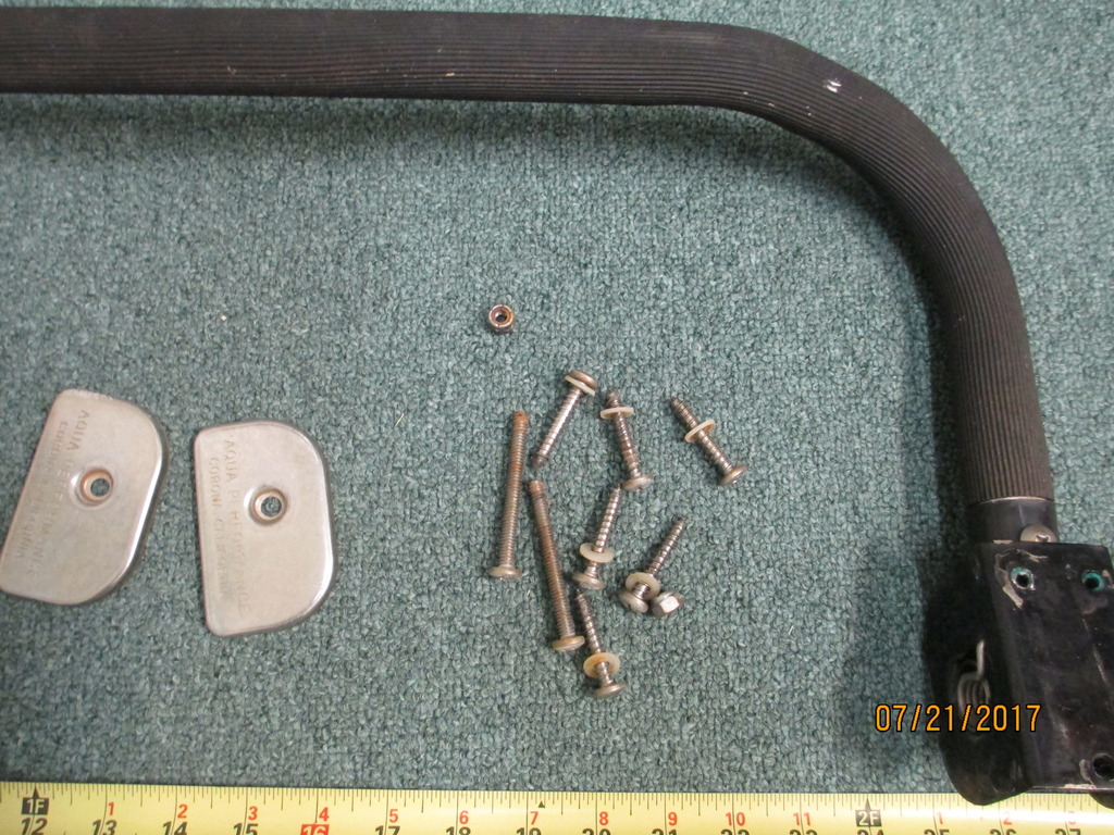

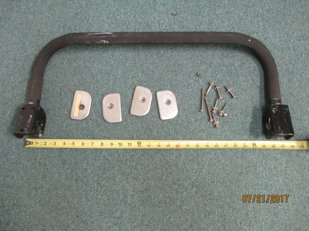

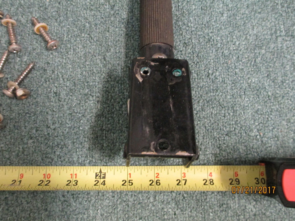

I can show you a pic of what the hardware looks like, Its just 3 screws on each side and a plate that cover's it....
your purchase should include everything needed to mount it. and those steps shouldn't sell for more than $30,,,, I had two listed for $30 each for 60 days and ended the listing because nobody bought them and tossed them back on the shelf.
From end to end 27" This is an Aqua step, which is the only brand I've ever seen TBH.
the 3 screws go right into the hull, the long bolt with the nut holds the bracket covers on.
Pic's...
