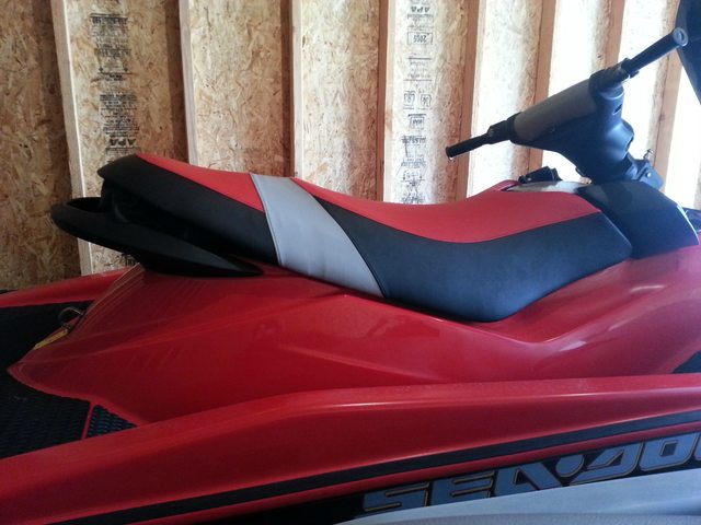

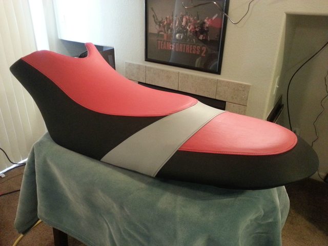

Here's how it turned out:
In the second picture you can see the indentation in the seat where the old strap was. I might get another strap made up to put on there but I haven't decided yet. Also, you can sort of see a line along the grey/red borders - Hydroturf glues a strip of rubber-ish material on the underside of the cover - presumably to seal these seams, but you can see the outline of it when you get the cover on tight. (another view, and another) This might not be a problem if you're putting the new cover over foam (rather than an old cover).
