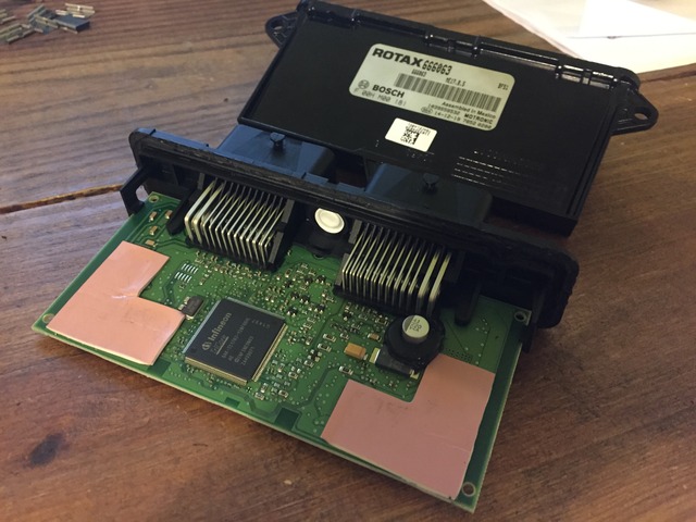

currently working on a tune for my '15 60hp spark. still a work in progress but coming along nicely. :thumbsup:

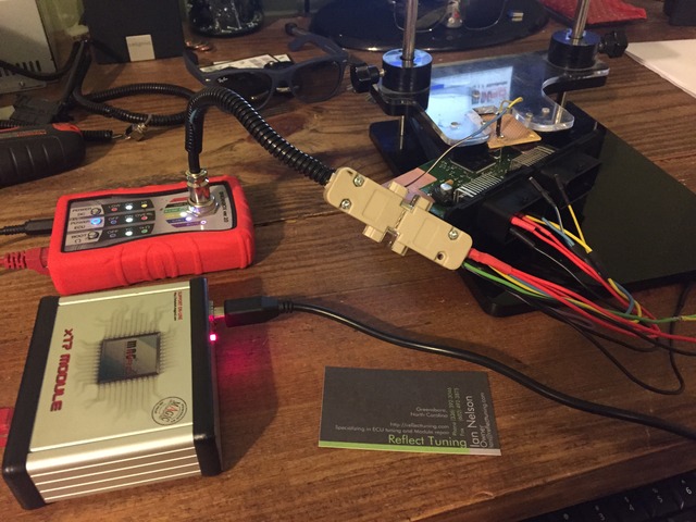

bench reading and writing ecu with magic x17 tool.
original 60hp files pulled from the ecu: http://goo.gl/AQDYch
Application number:103 BL IROM
Checksumm AUTO
-- Identification ECU
Connect to ECU...
Connected OK
PROCON0: 000087FF
Read protection and global write protection is installed.
PROCON1: 00000000
Memory configuration
Sector Address Size OTP User0 WP User1 WP
00 0xA0000000 0x00004000 RW WP No WP
01 0xA0004000 0x00004000 RW WP No WP
02 0xA0008000 0x00004000 RW WP No WP
03 0xA000C000 0x00004000 RW WP No WP
04 0xA0010000 0x00004000 RW WP No WP
05 0xA0014000 0x00004000 RW WP No WP
06 0xA0018000 0x00004000 RW WP No WP
07 0xA001C000 0x00004000 RW WP No WP
08 0xA0020000 0x00020000 RW WP No WP
09 0xA0040000 0x00040000 RW WP No WP
10 0xA0080000 0x00080000 RW WP No WP
11 0xA0100000 0x00078000 RW No WP No WP
Detected TC1766 processor
Checking tprot version number...
Detected TPROT 5-7
Finished OK
Loaded file: C:/Users/k0mpresd/Desktop/SeaDoo Spark 60HP ME17.8.5/WinOLS (SeaDoo Spark 60hp (Stage 1 8350rpm ) - 544876).bin
File load OK
Checksum calculation, please wait...
Checksum updated
Finished OK
Write data
Skip sector A0000000 - CRC OK
Skip sector A0004000 - CRC OK
Skip sector A0008000 - CRC OK
Skip sector A000C000 - CRC OK
Skip sector A0010000 - CRC OK
Skip sector A0014000 - CRC OK
Skip sector A0018000 - CRC OK
Skip sector A001C000 - CRC OK
Erase sector A0020000...
Write sector A0020000...
Skip sector A0040000 - CRC OK
Skip sector A0080000 - CRC OK
Skip sector A0100000 - CRC OK
Write 131072 bytes
Write file in 1 minutes and 1 seconds
Finished OK
