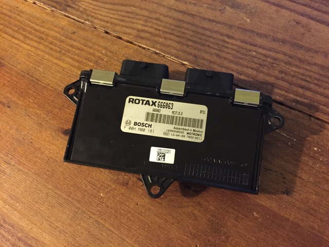

how to: remove ecu from seadoo spark.

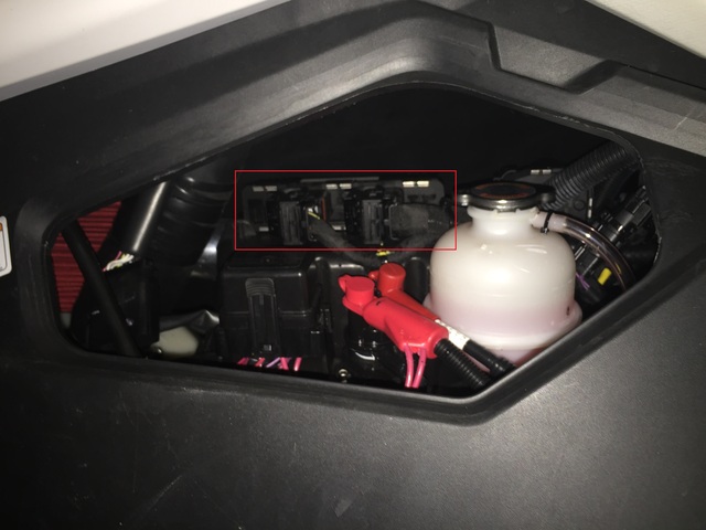

  • remove engine access cover.

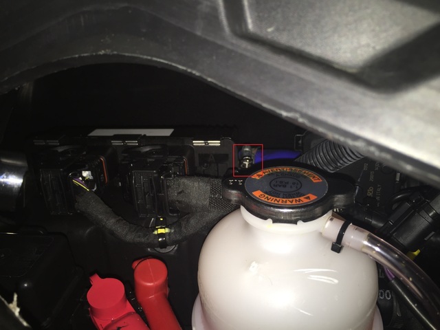

  • remove 3 7mm head bolts securing ecu to airbox.
    1 on each side and 1 directly in the middle on the back. these are easily removed with a 1/4" ratchet and 7mm socket.
  • remove 2 electrical plugs from ecu.
  • remove ecu.
