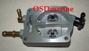

The fuel pump has two one way valves and is inside the forward carbureator (if you have two carbs). It looks like this: https://i.ebayimg.com/images/g/258AAOSwCypWppYc/s-l300.jpg
There is a diaphragm on top of that assembly that flexes in and out from a pulse line from the engine. As it flexes, it pushes air/gas through the two one way valves and pumps fuel. It actually pumps quite fast--even after replacing all fuel lines and emptying the water separator in my '96 GTS, it filled the entire system in about 3 seconds of cranking.
If the fuel pump has failed, it could be because of a leak in the diaphragm, disconnected fuel or pulse line, or some other failure. Check that the pulse line (the short fuel line that goes from the engine to the carb) is connected and not leaking.
If there's an internal failure in the fuel pump, a carb rebuild will fix it. There's good information on how to rebuild your carbs here:
