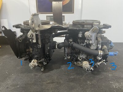

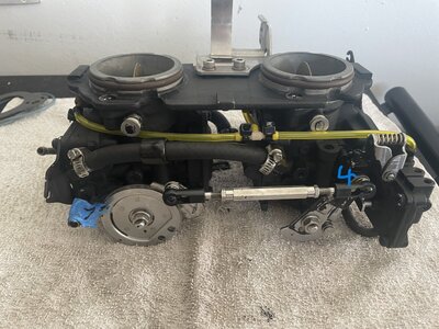

I am in the process of a resurrection of my 2001 XP. I rebuilt the carburetor (with 'mikidymac' instruction thread). XP fires up, seams to idle good, runs slow , no 'pop' off (quick acceleration) speed and only 1/4 of performance (speed) from the past. Looking to adjust the carb. I have attached pictures of the adjuster screws locations. Would someone educate me on what each of these screws are? Idle. low speed, high speed and the 4th? I found a great post of how to adjust each for top performance, but don't know which screw is what.
