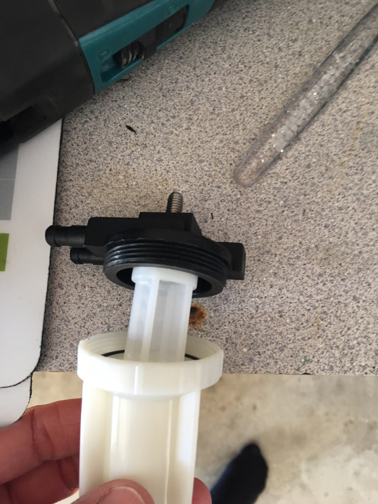

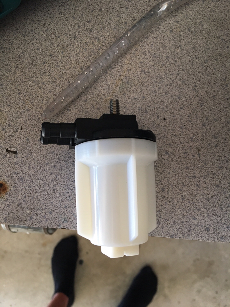

Hello,
New member asking for help in physically installing a new fuel filter in the 2000 XP model. The top part piece holds the fuel lines, and the bottom part is the fuel filter and the holder for it. I assume the holder just unscrews from the top, but it does not do this with moderate presasure, and I don't want to force it and break it.
I did post this earlier, but did not find it anywhere. New member trying to get the drill...
Is there some other action I need to take to change this fuel filter?
Thanks,
Bob
The bottom part should twist off. The filter is inside and should stay on the top part as it is lightly pressed into/onto the top part. If the parts have not been apart in a while the plastic will tend to stick together. Also there is an o-ring that seals the upper and lower pats. If that seal is missing it will leak air into while riding and leak some fuel out. So if this was the issue someone may have over tightened to stop the leak. Check the o-ring when you get it off. Try some channel lock pliers to aid in leverage just don't apply much squeezing pressure to the plastic or try a strap wrench.
Yes, just unscrews.
Thank you gents for the details and pictures. Exactly what I was hoping for on the forum.
