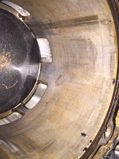

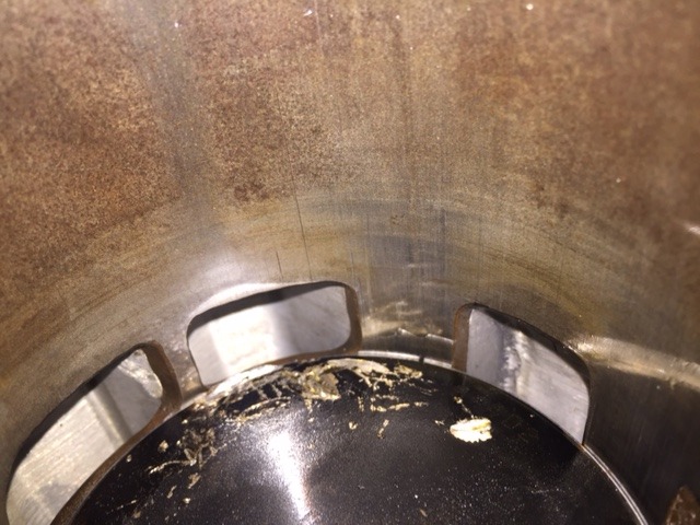

I believe in the benefit of cylinder porting. However there is a lot more room for improvement in post 95 787's. More time was taken to make smooth transitions between the sleeve and the cylinder and the exhaust ports are slightly higher in the 95's. It's possible someone could have cleaned this up in the past but look at these 95 intake ports
My exhaust porting was open 200 duration exhaust! But this porting was not the best.. To high for stock exhaust..

Wow Matt. Those 95' cylinders look nothing like the stock 787's I have seen although I have never has a set of 95's either. Those look great. All the 787 and 720's I have seen have pretty poor port matching and are raw castings not like the polished ones in your picture.
Yeah that does look a little better then stock I guess. This motor had a billet head on it so someone probably did some clean up work in there. It ate something and won't roll all the way over so I have to tear into it. I'll probably set those cylinders aside for myself.
Per the 96 race manual the 95 cylinders have different port timing than the later years
I don't doubt that but those ports look like they were really cleaned up. I haven't seen any 95 cylinders but as the 95' s were made to keep within the racing production rules and were bored oversized from the factory I could see them cleaning up the ports too.
