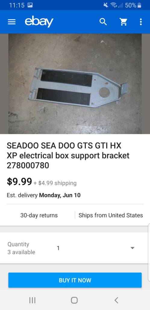

Has any one had to fix the clips that secure the box down? If so what's a good product to use. Went to remove the box lastnight and both clips and both clips just snapped right off. Must get brittle over time I guess.
It's not the clips on the box. It's the two clips on the mounting plate that holds the box. I'm not sure how that plate is attached to the hull but I dont want to replace it. I got some 3m plastic repair to try to fix it.
If that’s all it is, you could probably even use some Velcro strips to hold it in place, or drip a couple of holes in the bracket and use a rubber strap like the battery is held down with...
It's literally a 15 minute job. Drill out the old rivets, pry the mount off, drive the remaining part of the rivets into the hull. Lay the new piece on, rivet it back down, install the ebox and go pound waves worry free. Really, it's not hard and it's repaired the right way.
Epc.brp.com go there and look under Seadoo watercraft. Find your ski, look under the electrical. It will give you all the part numbers, go on eBay and go shopping. Heck, I might even have the mount and rivets.
