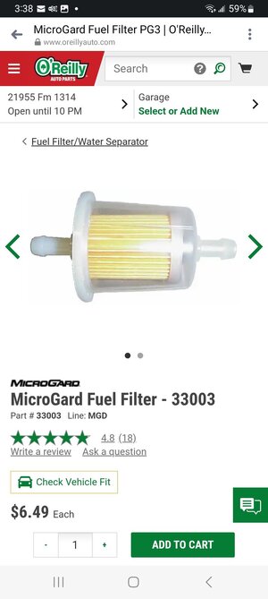

I was thinking about taking the my premix line off the selector and using a connecting barb connect it output line of fuel filter, omit selector and filtetYou can bypass the filter and selector valve by putting a tube straight from premixed gas to the carb inlet. If it works then, you know it’s the filter or valve, if it doesn’t then it’s the carburetor
I better pull off reserve tank hose off selector and pug it with a bolt and clamp, incase fuel selector is bad and off position is not working. Getting correct fuel line size in my area has been a issue, they never carry much off the real.going direct will eliminate possible issues but if the selector or filter does end up being the issue it shouldn’t cost much to replace them

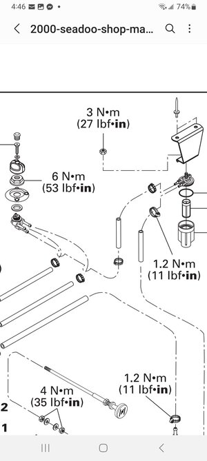

I’m sorry, that although probably pretty basic is something I would have to look at in the manual. I usually take a lot of pictures to see where everything goes, pretty new at all this myself. If you can’t get it, I can go out and have a look at one of my machines when I get back inOh, one more stupid concern does the return line go straight back to the main pre mix tank and not reserve tank
