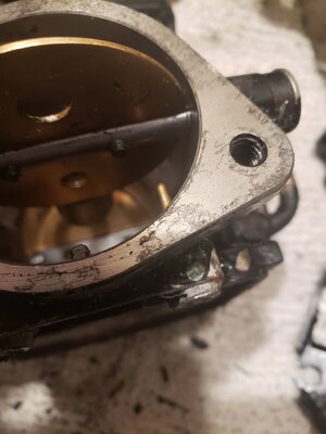

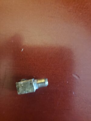

Unfortunately, a fuel fitting broke off while removing the fuel line. Anyone know what the part number and name is and where I might find one to purchase? I can't seem to find it anywhere. Thanks.20230829_072409.jpg20230829_072415.jpg
Maybe you could drill it out and tap some new treads in and use a brass fitting. Depends on where its at
Take a picture of the carb and where the fitting was located. I have some parts carbs.

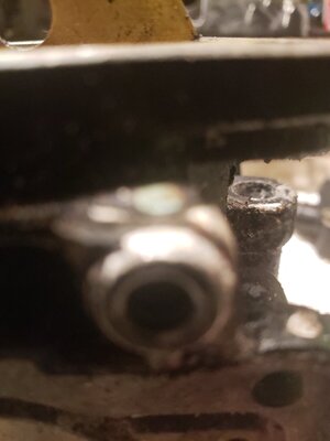

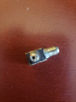

Thank you! Here's the photos, while it might appear to be a one piece fitting, it is actually two pieces. The one that broke off is on the outside. It just pops out of the fitting with no gasket.20230831_072229.jpg20230831_072253.jpg20230829_072409.jpg
Looks like an accelerator pump nozzel and that fitting is a check valve. If that fitting broke you have worse troubles than that. That nozzle is likely plugged up as well and unlikely you'll never get it unplugged. I've fought a number of these. :) I'd block of the accelerator pump and up the low speed jet size to compensate. Cheaper than buying a new carb.
