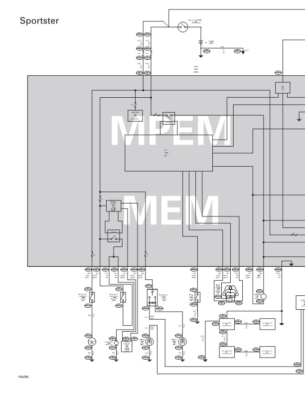

Here is the systematic for the electrical system.
Perfect, thanks very much! For some reason, all my accessories and mpem were wired to the starter side of the solenoid...and they did not work! I rewired them to the battery side of the solenoid and they all work now. I just bought this boat a few days ago in a 'non-working' condition.
