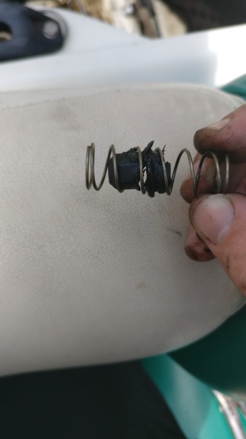

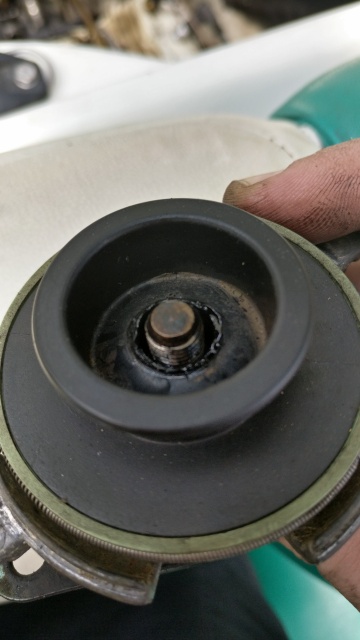

Tore into the RAVE valves since they were an easy place to start. The top diaphragm was melted where the cap screws on in the rearmost RAVE valve. I don't know if this would cause my problem but it needs fixed regardless.
I wonder if you engine is overheating and is the cause of both the bogging down and melted rave valve? Does your buzzer work?

Clean all the raves. Poor choice in oil causing them to stick. Yes, that's your problem. IF, it persist, inspect the ones on the muffler. Good job at diving into ur

I had this issue with my challenger 1800 in the past. I melted a few rave valve diaphrams before I realized the rave valve body was worn and I was getting blowby up the shaft. A new valve body fixed that. A carb rebuild fixed my mid RPM bogging issue. It never seems to end with these boats. Luckily the parts are cheap and the engines are easy to repair.
