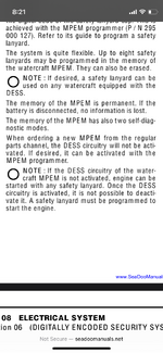

Well after thoroughly going over the repair manual, it seems like the mpem isn’t reading my key anymore. I’ve checked the post resistance and it’s fine, open with no key and closed with the key on. So the post is fine. Does anyone know where I can get a new mpem with a key? I figure I’m covering all the bases if I replace both.

The 2 beeps I get are when it’s in advanced diagnostic mode, then the key is inserted then start button is pressed. According to the manual that means the key isn’t being recognized.
When just putting the key on, there’s no reaction from the ski. Pressing the start button with key in, one long beep and gauge comes on for a sec
How sure are you? I read in the manual that before it’s programmed any key will start the machine. But once it’s programmed it can’t be unprogrammed so from then on you’ll always need to program a key to start the machine. Anyone have any experience with this situation??
