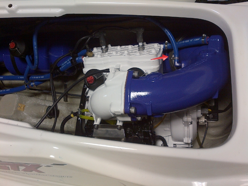

Honestly I just give it a scuff and wipe it down with some lacquer thinner and spray away. It holds up well, but I have not done any with the level of corrosion you have on that pipe.
This was just after install, still looks the same today.
