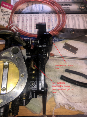

So I finished up the carb rebuild, tested everything per the manual and the great write-ups on this forum. I ran some fuel into the mag side carb inlet and expected to be able to see the accelerator pump squirt, but I don't see anything. Should I be able to?
As long as you get fuel into the carb and coming out the return hose then yes, the pump should squirt.
How does the fuel get to this outlet...what is the fuel ciruit?

If I hook a hose with fuel to the pump inlet, it squirts like crazy...it is like fuel isn't getting to the feed port to it?
Fuel comes through inside the carb body.
You need to check the parts diagram for your boat as some have a brass restrictor orifice in that feel line that has to be reinstalled from the old hose.

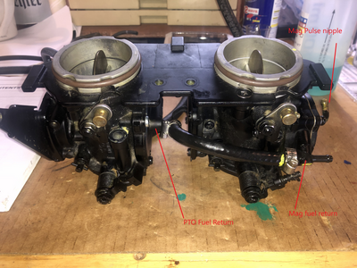

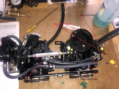

These fuel lines are hooked up correctly, right? I didn't change anything from since it was last running. And yes, I put the restrictor in the new hose. I cannot get fuel into that feed port to the accelerator pump...

Looks correct. The accelerator pump is fed from the fuel chamber in the PTO carb. Pull it back apart and make sure the passage is clear.
