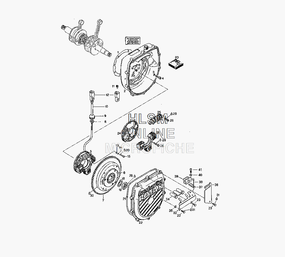

So I pulled the starter and the bendix did have some extensive damage. I ordered one. I am afraid the fly wheel might be damaged pretty extensively also. I'm going to put the new starter in and go from there.

Update: I have changed the starter and bought a new battery. It is now attempting to turn over but it's still very weak and will only do it maybe twice before I put the battery back on charge.
