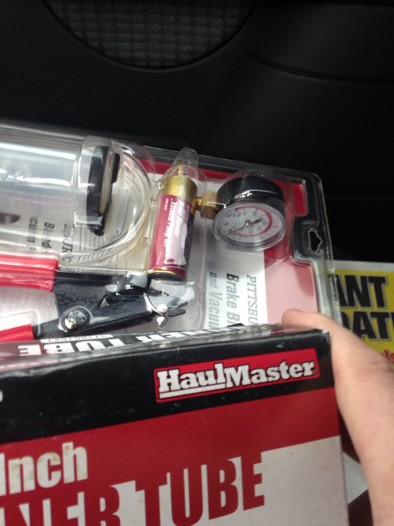

I know you want to fix that engine/carb issue, but I REALLY would pressure test the engine. I never was a firm believer in the spray and pray technique. If you want to borrow my chit just let me know. 1of500 has half of it and I have the top piece for the exhaust mani block off. I'll need to know so he can just ship it to you instead. You cover the shipping costs. Where you sprayed the stuff that gasket is about a 1/2" wide all the way around. You would need to have a pretty decent size void in that gasket or warp in the housing or loose housing. Just thinking logically is all. Well, that and pessimistically, no one is touching the bottom end of one of my engines. And magically it will take more than 2 hours and you'll be paying for them to install the tank and align the engine. Remember, they didn't really want to touch the ski and then he came around.......was that after you told him you wanted the seal replaced?
No he knew from the beginning, but i just bought this setup literally 15 min ago to pressure test, bc I was told this "bleeder" can also work as a pump, big just a vaccuum

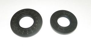

What Is that gasket? I thought the crank seal looks like this?
