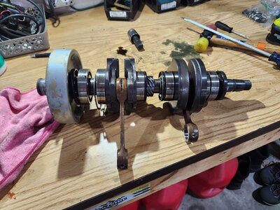

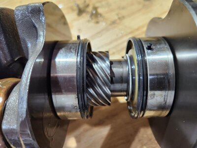

I picked up a 2001 GTS jetski with a 717 motor that was bad. I took the motor apart and found that the rotary valve gear has moved on the crankshaft. What would cause this and can it be fixed. All the bearings look to be in great condition
You need to remove the PTO and I have not seen gears that have shifted stay when trying to move back to center. I would say you need a reman crank.
