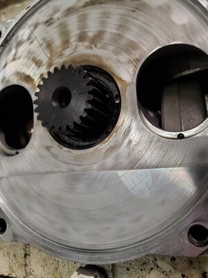

I was running my new to me 1996 GTi in the water trying to figure out an engine bogging issue that only occurred in the water. I bought this ski in the winter for $1000, previous owner didn't have it for more than a year and said he bought it just for the trailer it came with and that it ran great when he took it out last summer. Compression is 117 and 119 (harbor freight gage). It idled great in and out of the water, I tore into the carbs only to find they were clean and looked to be rebuilt recently (didn't touch the needle and seat). The mixture screws were also set to spec. Disconnected the red wire on the rectifier, still bogged. Ran it for probably 30 minutes total over 2 days with the engine bogging condition until I noticed a lot of smoke in the bilge. Further inspection revealed some oil around the PTO side of the engine. Found a rubber ring along with a chunk of crank seal in the bilge (image 2). Turned over the engine and saw the crank seal sticking up past the PTO flywheel (image 1).
I am guessing I am in full rebuild territory for this engine? Is it worth trying to just pop a new crank seal in?
Was the bogging issue related to this crank seal leak/failure?
