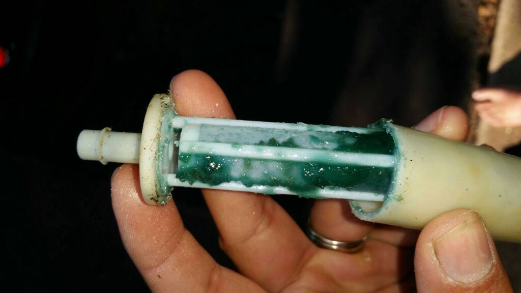

Just a visual of what Matt is saying. This is what I found in my oil filter when I bought my boat. Previous owner was using the wrong oil.
Well I took off the intake and have been inspecting the oil lines visually. Is there a way to tell if these lines are becoming "brittle" and "collapsing" like so many other people say happens? I have new hose but I thought I would show this to you all first. Also am wondering if the nozzles could be gummed up with last owner used wrong oil perhaps. I did replace the oil filter.
