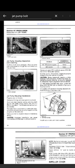

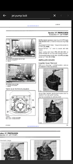

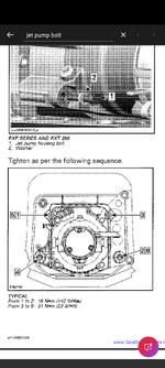

Hi. Just replaced my wear ring and impeller and can not confirm the torque spec for the four bolts to mount the pump back. I have read 18-23 ft lbs. Can anyone confirm? I put them at 20 ft lbs.
I found the attached in the shop manuel. The last attachment shows 23 ft lbs. I was going to torque them to 24 ft lbs initially, but decided to back them off to 20 as they felt too tight with the plastic housing it bolts to.
