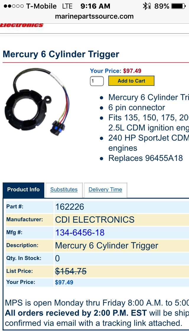

Just an update, I started to have issues again with stalling and low power. I pulled the flywheel and changed the trigger, runs really well now, better than it ever has. I truly believe I had multiple issues and this was the final problem. Hope this helps
thanks for the information I replaced all 6 coils filter and spark plugs I order the trigger I hope that do the trick en put me back in the water thanks again
