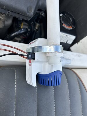

Picked up a modern Rule 500GPH and spliced it in. It comes on with the helm switch but not automatically when submerged or tipped upside down. Fuse at the helm is good (else it wouldn’t turn on with the switch). Anyone know of another fuse or similar with the original wiring? I’d prefer not to wire directly to the battery.

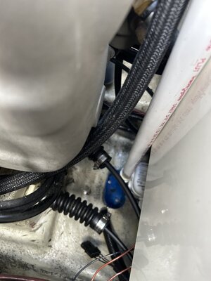

Here’s what I’ve done to get around drilling holes in the bilge floor:
Basically just mounted it to a 3/4” run of PVC using a large hose clamp, and I’ll mount the PVC to the wall foreword of the engine. Should make it easy to pull it out to clean/replace plus it gives me a direct route to the bottom of the bilge if I ever need to manually pump it. I’ll leave the original mount intact so as not to leave holes where it was riveted through the floor.
