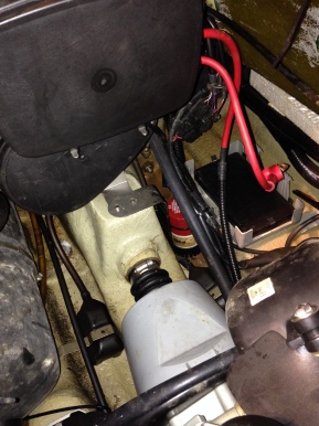

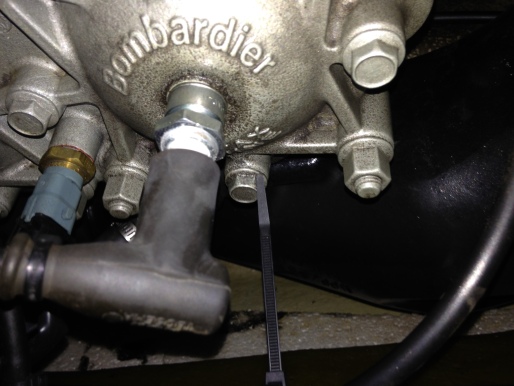

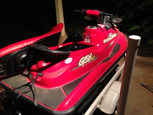

Quick back story. My brother bought this ski brand new in 1999. He meticulously took care of it (let the dealership take care of it) until he abandoned it 5 years ago. I don't think he winterized it, just pulled the drain plugs and put it in our parents basement. I finally talked him into letting my "go through it" and get it up and running.
All i have done to this thing is tow it to my house and take off the seat. I do have decent skills and decent tools, however I don't have any experience on seadoos.
First question I have is, do I simply follow the instructions in the manual for "starting after storage", or does anyone have a comprehensive tried and true system after long period of storage.
I am thinking replacing all the usuals:
1. battery
2. drain fuel and new fuel filter
3. drain oil and new oil filter
4. check/ replace air filter
5. spark plugs

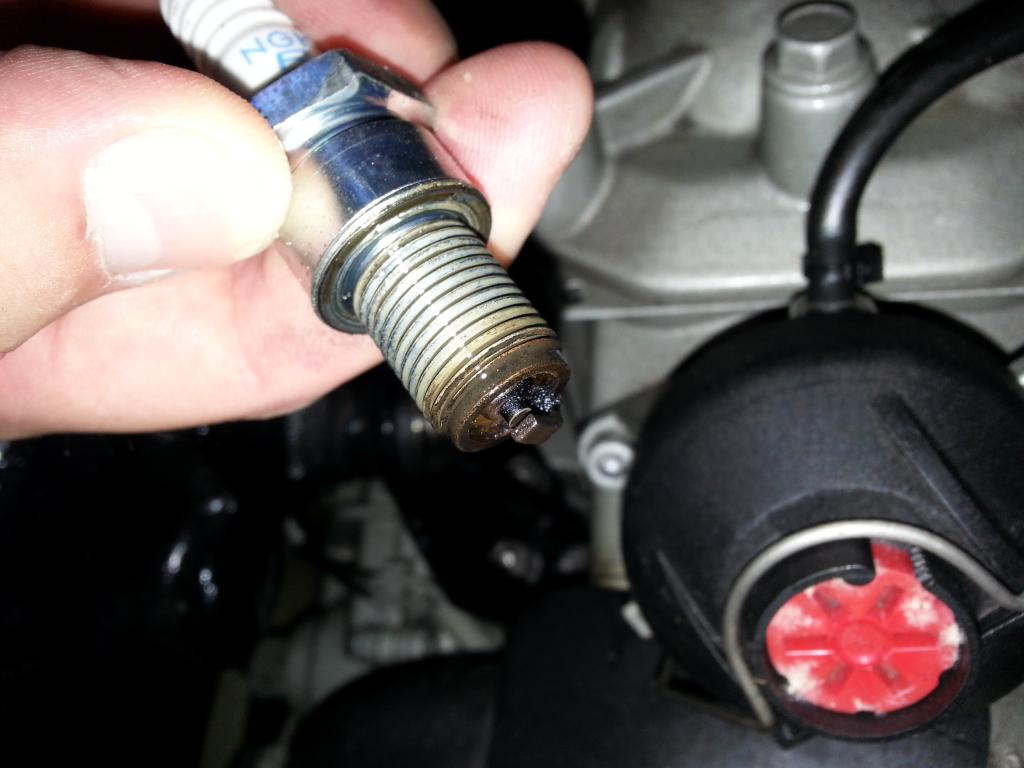

Now, I want to check compression, however before I hard fire this thing up, would putting oil in the spark plug holes and letting it sit for a while, then hand cranking the pistons slowly be beneficial?
Read that spraying seadoo lubricant into airbox to lubricate the top in should be done too, but that is while the motor is at fast idle.
GSX also has grey fuel lines.
Some pictures to show what i am getting into.
