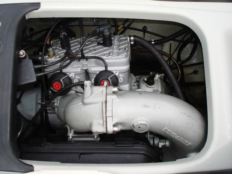

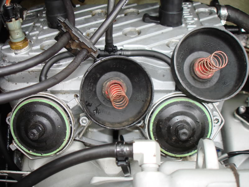

I have a 1998 GTX Limited and have had a long going problem I would like to get to the bottom of. We bought the ski new in 1998. The ski is going in for service to a new dealer in the area and I am hoping they can get it right. It has been going to Alex Sterling Marine in Baton Rouge and they don't seem to have a clue what is going on and are more concerned about charging me for things that aren’t broken. About 6 years ago the ski started having a hesitation problem where it would not rev up past 4-5k rpm and would intermittently "take off" at full power and blast up to 65mph. We took it to a dealer in Baton Rouge and they insisted it needed a new motor. They said compression was around 110psi on each cylinder. We let them change the engine and when we got it back it ran but never ever jumped out of the water when pegging the accelerator like it used to before it went in for the new motor. This thing is just slow as hell to rev up to peak RPM and just isn’t fast anymore. It will still do 50+ but it takes forever to get there. When you do peg the accelerator it just slowly revs up to peak RMP, no burst of power like before. I remember it used to be a rocket ship. I know the dealer we used to take it to was a total slouch. They never serviced it properly and would only fix one problem and skip another. I know the RAVE system has never been serviced. I took the caps off the two rave parts on the pistons and they moved freely but seemed a little gummy, if you will. They weren’t quick to pop back into position. I don’t know Jack about the rave system or how it is supposed to work. I was hoping you guys could give me a list of things to insist the dealer check and recheck.
The reason I am finally bringing it into the dealer is that the front piston is not getting fuel and the engine won’t keep running after the initial spark off of the piston that is getting fuel. I checked the plugs and both are sparking and the engine will run if I leave the front plug out and there is no fuel smell. I do a lot of work on modern cars. Do I need to replace the injectors or how should they be serviced. I know for a fact nothing other than batteries and wear rings have ever been serviced on this ski. The ski goes into the shop on Monday and I would appreciate any advice you can give me to get this thing running like it used to.
