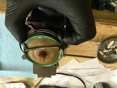

I'd just clean the raves up. I think that is a good end of summer maintenance practice.
I am cleaning and rebuilding the rave valves. I see it says to use synthetic grease when putting back together. Is that just some of the synthetic oil for the ski or special grease I need. Also where can I find torque specs for the reassembly.
Syn grease for what?torque spec for what?no grease on rave valves.tighten the Allen bolts with loctite.raves need to be put together clean and dry.
Thank you. In the manual it shows to apply syn grease to the rubber piece and I didn't know if Allen screws needed tighten to torque spec.
No grease on the bellows.and just snug up the 5 mm Allen with clean threads and red loctite.make sure the bellow springs are in good shape.
I’ve used blue loctite , Red needs heat to break them free. Manual calls for blue, at least on my 99 RFI manual.
If prepped correctly with perfectly clean threads blue would work a drop of red will come off just fine.never needed heat to remove bolts with red loctite.been doing this a long long time

I've had one spring break when I was installing it by hand which is how I do it so you can go too far with it for sure. :) I put the springs or o-rings on the bottom of the bellows as well. It doesn't call for it but I do it anyway. They seal better and help any oil drips. Viton is the best o-ring choice but the spring is the best.

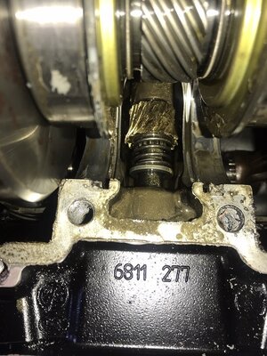

I've had two people put gas in the oil reservoir. One was smart enough to drain the tank. The other person ruined the rotary gear. I'm gonna put labels on the skis now.
No one will own up to it. I drained tank took it out and cleaned it up. What is the rotary gear? Do I need to do anything else before firing it back up?
I was waiting hoping Etemplet would respond to your question , perhaps he will later. The rotary gear is located in the Center of the crankcase, the gear is seperated from the outer sides of the crankcase by 2 oil seals and runs the rotary valve. There is an oil line from the oil tank to the rotary valve cavity. I would empty as much oil from the rv cavity as I could because it wouldn’t have the same lubricating properties being mixed with the gas as the straight 2 stroke oil would. Maybe try blowing air sideways past the nipple to get some of the oil out. Once you’ve gotten as much out as you can and have re filled the oil tank I would think you should be good. Whatever little bit of gas that’s left in the rv cavity should mix with all the new oil you’ve put in and be ok. Make sure when your filling the oil tank to fill right up so the rv cavity gets replinshed with the new oil

If you have a mitey-vac I'd hook a hose onto the lower fitting on the rotary valve chamber and vacuum out all the oil/gas mixture out I could. I'd also refill the chamber and vacuum all the oil out to give it a good flush. Then I'd hook the system up and refill the oil tank.
Here is a picture of the rotary valve shaft, engine cases split and the crankshaft lifted up a bit. The dipshit that filled this oil reservoir with gas didn't correct the problem he just ran the ski.
