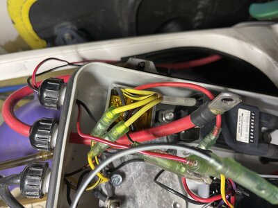

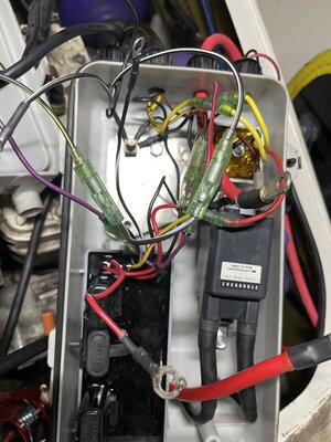

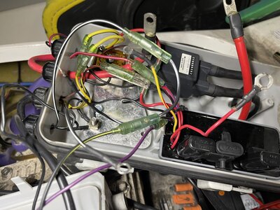

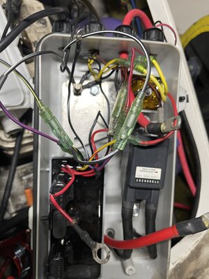

Hello everyone I am new to the jet ski world. I was gifted a 1994 GTX from my 65 year old neighbor. He took the electrical box was out to replace the solenoid he never put it back in (its still in the package from delivery a year ago..) I have searched and searched for a detailed wiring diagram and no luck. there is wires disconnected from the solenoid. I have wires everywhere. i am attaching pictures in hope someone on here can assist me or direct me to a schematic/diagram to reinstall the wiring. thank you

I helped someone with a previous electrical problem by looking at the schematic in the 94 seadoo shop manual that was on seadoomanuals.net. This site is no longer assessible. Since you are a premium member you should have access to a lot of shop manuals through a link at the top of the forum. I think the schematics were at the end of manual or in the eletrical section.1
Seadoo sells 295500900 which is a conversion kit to switch it from the old style solenoid to the new style Seadoo solenoid. it changes the small posts on the old solenoid to the new style plug. they are still available and they are about $50 CDN. has instructions in it for hooking it up.

thank you. I finally had a chance to get it wired correctly with new coil. thanks again. i get it to turn over, I have spark but it will not turn over. gonna check carbs and fuel line.
