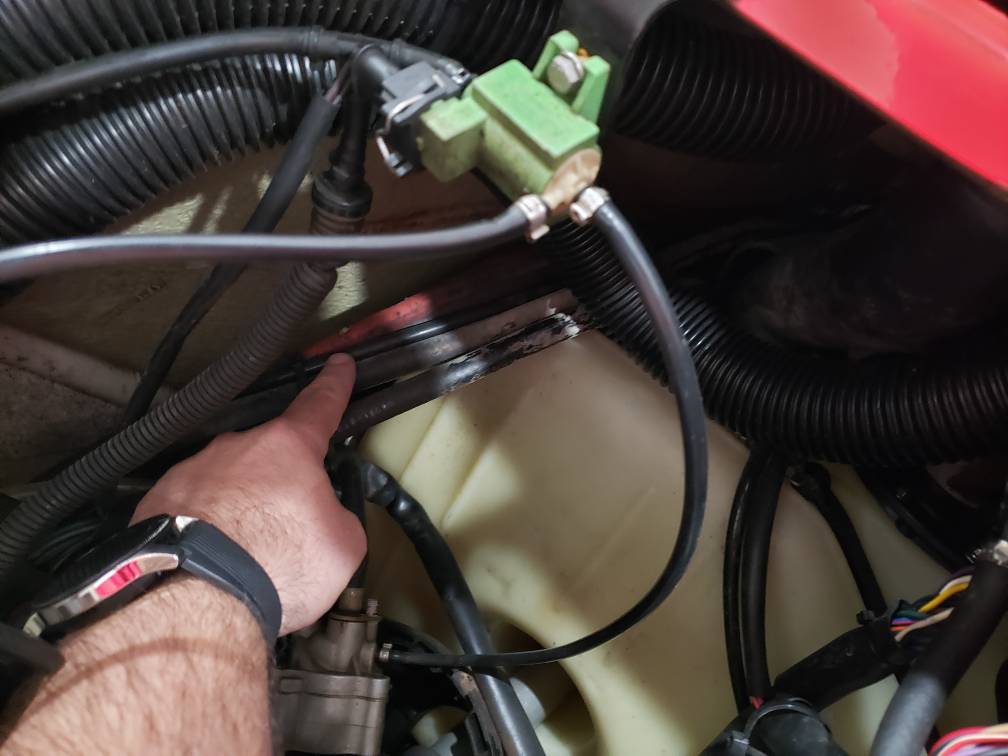

ok, so lets see..

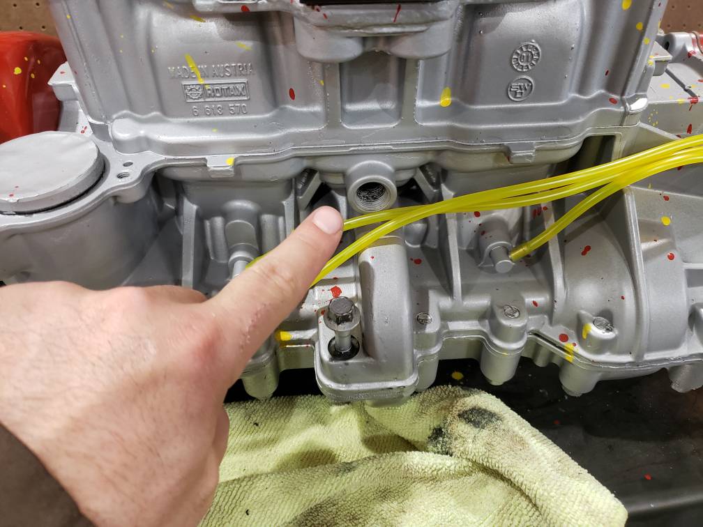

the 1st pic, goes to the top port on the exhaust

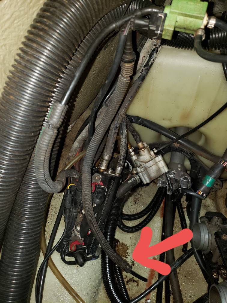

second pic, i cannot tell the origin

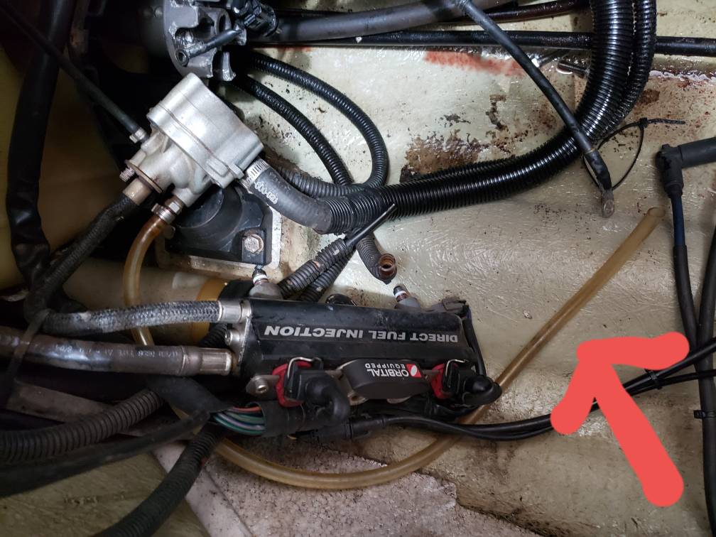

3rd pic is the knock sensor, that goes on the head

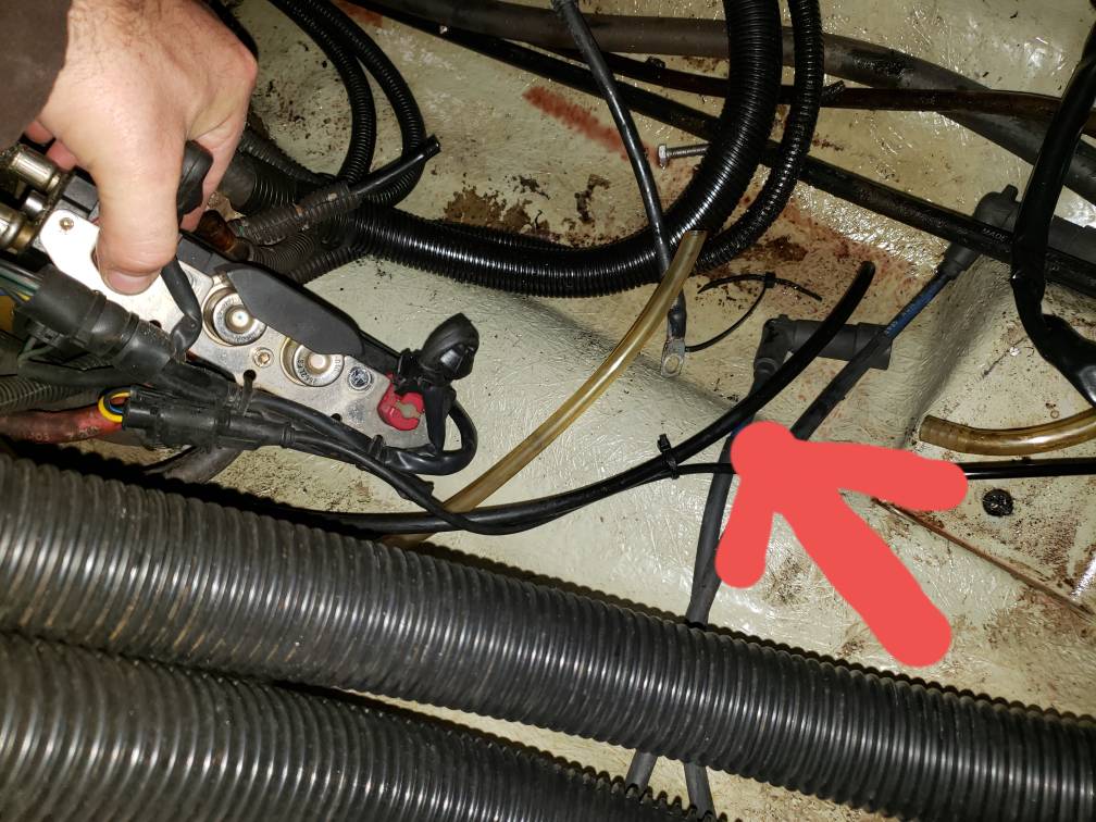

4th pic goes to the CB vented plug

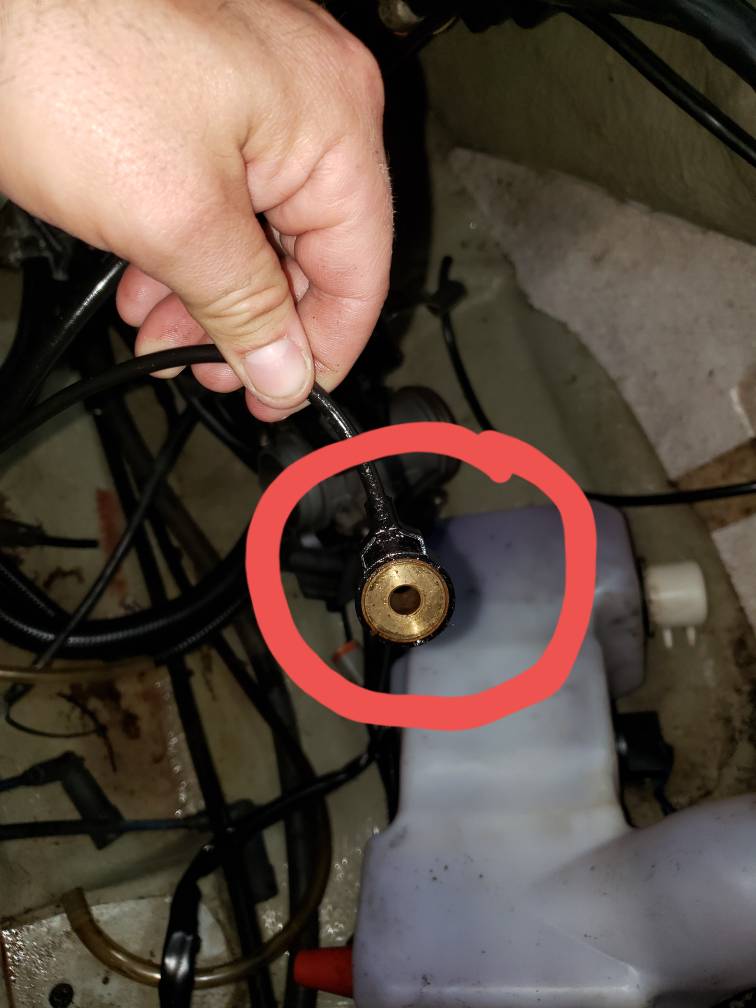

5th is the drain
here's a cheat scribbled up pos sheet i made up.. I can read it so that's all that really matters
