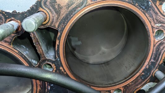

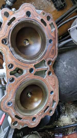

I have a 99 GTX LTD that was running OK until it all of a sudden stalled. Now it will barely start, and will only run for like half a second before stalling again, and it sounds like there's some kind of rattling happening. Compression is 120 in front and 150 in back, so obviously that's a problem. I just can't really figure out why. RAVE valves are not damaged at all. I took off the head expecting to find damage to the cylinder or piston, but to my novice eye nothing seems wrong. Then again, I don't really know what I'm looking for so what do you guys think?
Pics in order: head, back cylinder, front cylinder

Sounds to me more like a fuel issue than compression. Cylinders look pretty good. I'd check compression again but you already have the head off. :D Good Luck !!

No reason for the raves to be damaged. Your pistons are 1mm over which is about the last size I use. You can go bigger of course it just costs more. Measure the cylinder bores since you have access. I don't see a reason why compression would be low other than normal wear. As for the 150psi reading that seems very strange.

Those pistons look lean and it is hard to tell but the cylinder walls don't look great.

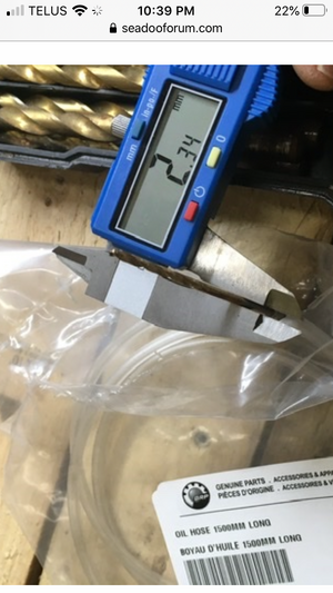

C3726681-5E64-416A-96F0-1AED63D3A844.pngI ordered this small oil line from our local BRP dealership for one of my snowmobiles, it’s the same line for the seadoo’s Part number 219704404. It was 1500 mm long which is 5 feet and I paid 20.99 Canadian plus tax for it which would be about 0.50 in US funds. I’ve never ordered the 8mm and 12mm, for whatever reason those sizes always seem fine but I think I will order some anyways just to have. The oil lines are one thing I like to buy OEM.
