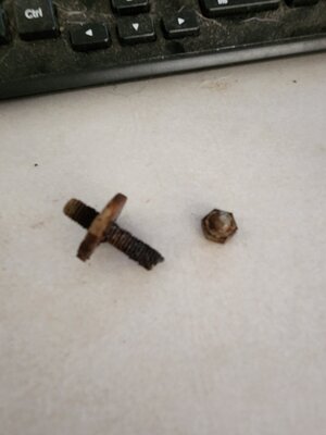

- Started to remove grips to inspect actually buttons behind covers & install the covers
- Bolt head snapped off the bolt going into the retaining clip
- Grip on this particular side was in bad shape from boat rope chafe, was able to just pull right off.
- Otherwise I would have cut it off
