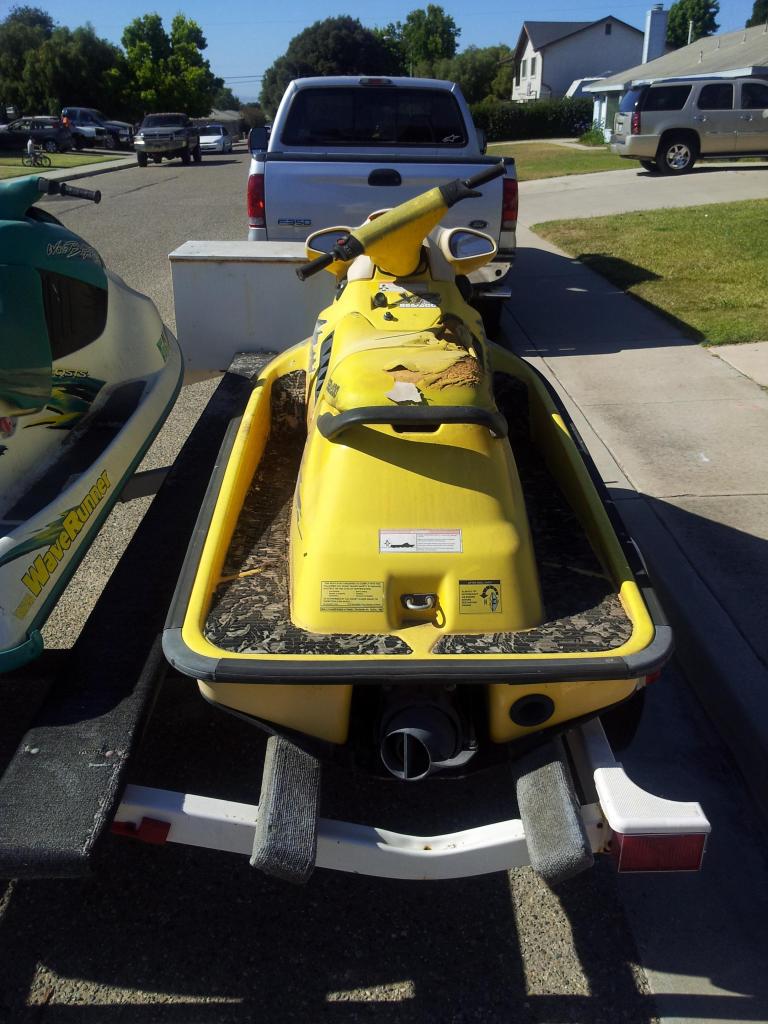

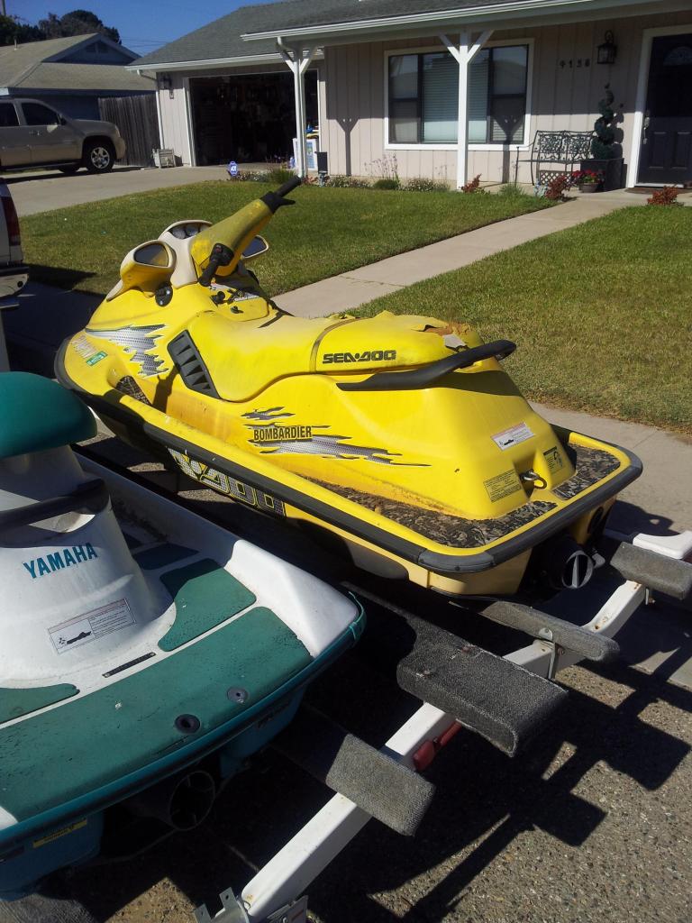

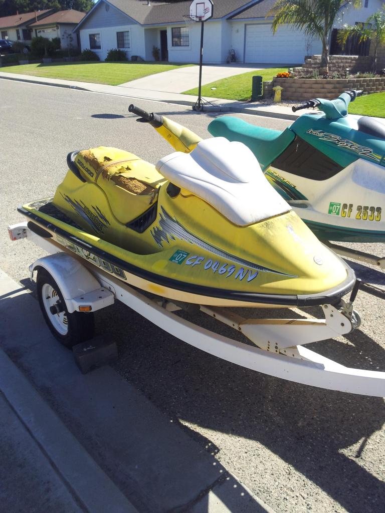

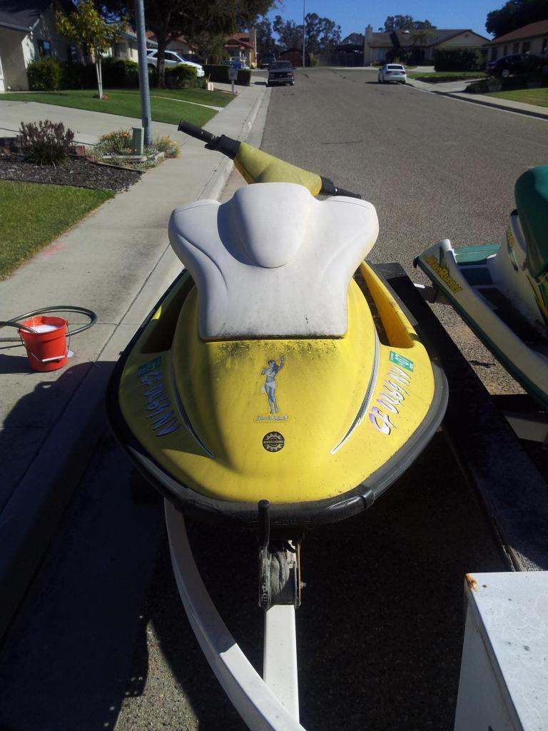

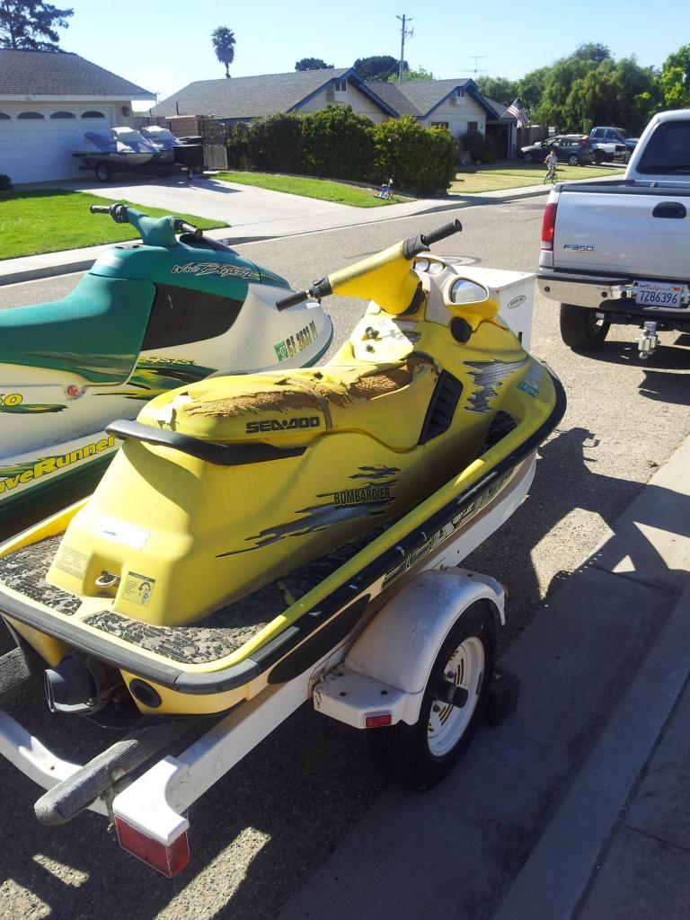

So, a couple years ago I bought a 1996 XP, 1997 WaveBlaster 2 and a double Shorelander trailer from a friend's neighbor for $500. It has been a few years but I am finally getting around to restoring the XP. I have owned many skis including standups and sit downs and even got out of the sport for about 10 years but I have always loved seadoos so when I saw these rotting away in a driveway over the years I decided to talk to the owners and make them an offer. The owner had knee problems and could not ride them anymore and was glad to have his driveway back.
The skis had been without covers for a couple years and the XP was in the worst shape. The WaveBlaster was in better shape so I cleaned it up, changed the oil and fuel, rebuilt the carbs and ran it for a season. It was fun to ride but maxed out at 45 mph. My son loved it because it was "fast" and sprayed water up from the back. I decided it had to go so I sold it at the end of this summer for $1,650 and decided to use that money to build the XP.
Here they are as they arrived home.

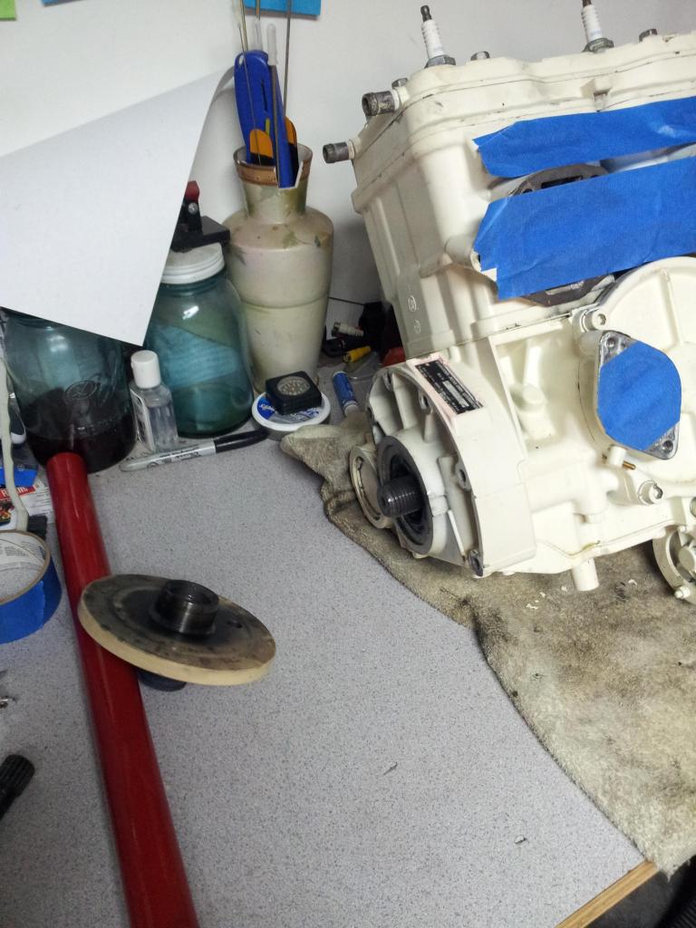

The engine was pulled and after a leak test the rotary cover o-ring was shot and leaking so I decided I would take it down and replace gaskets and seals.

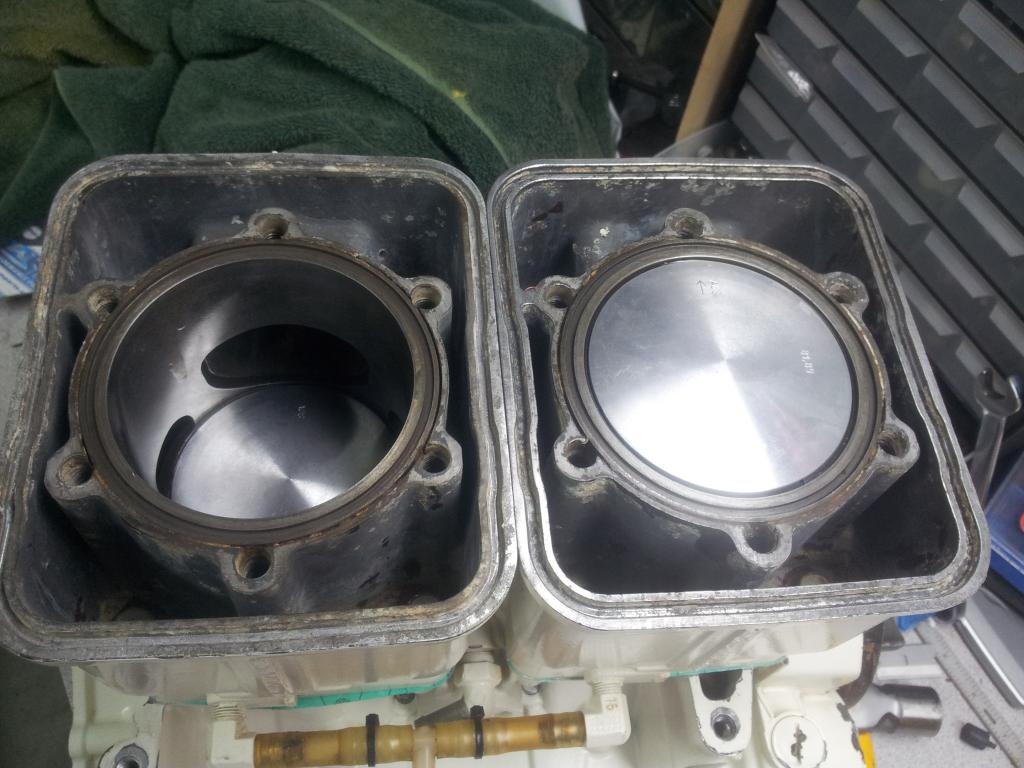

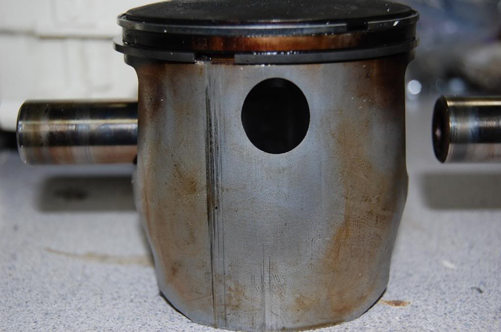

Pistons were in good shape and the scuffing looked fresh probably from my attempt to fire it.
Cylinders looked good with a little cross hatch left so I took it to my machine shop guy ant they were a little out of round but within spec so I ordered some OEM standard size pistons and hit the cylinders with a ball hone.
The crank looked good so it got new seals.

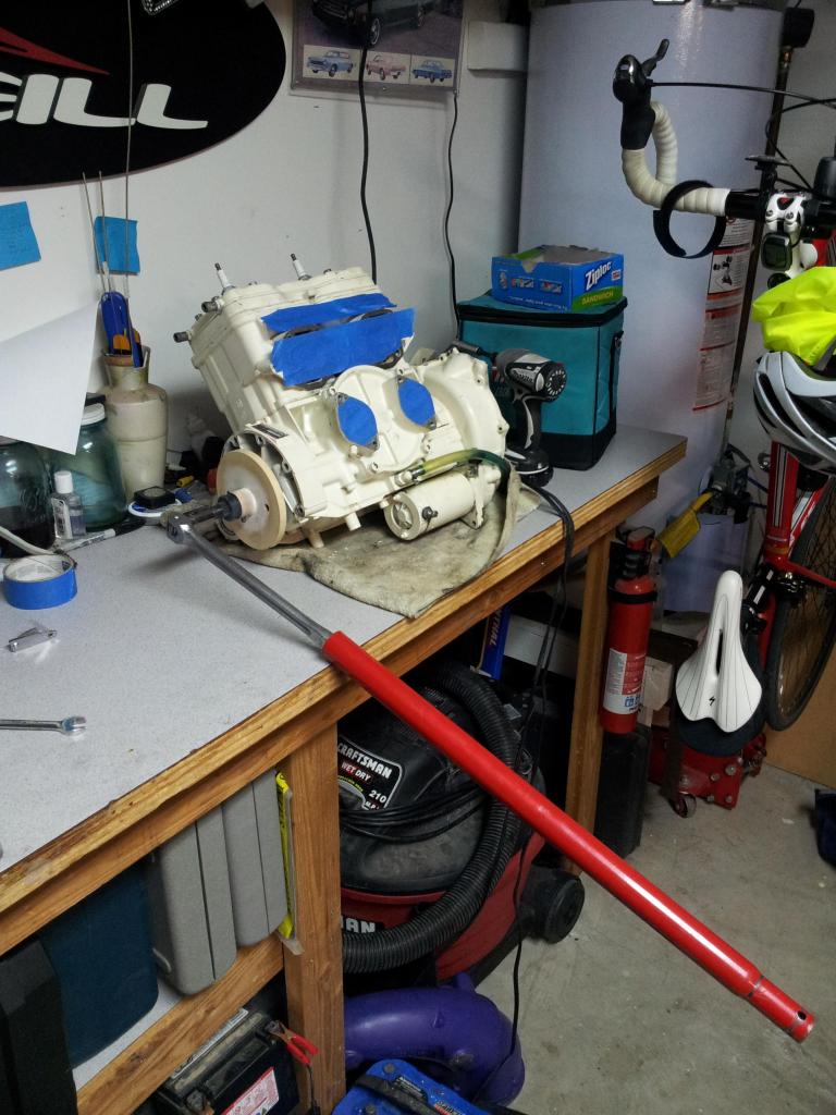

Here is his going back together...
For me I got a new OEM crank, new first over pistons, sent the cylinders to Group K for boring and honing, rebuilt counter balancer and rotary shaft with all OEM bearings and seals.

Looks like the previous owner put the 99 Spx decals on the front and looks like maybe 98 99 xp rear decals. Nice looking project.

The lower decals or the seadoo ones are from a 99spx as well
