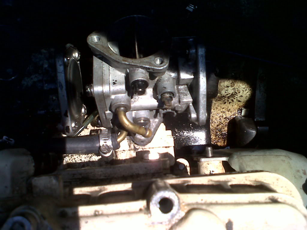

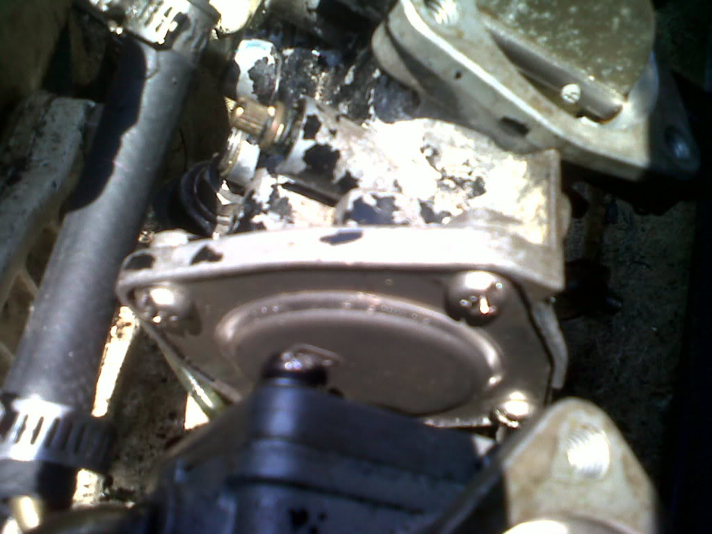

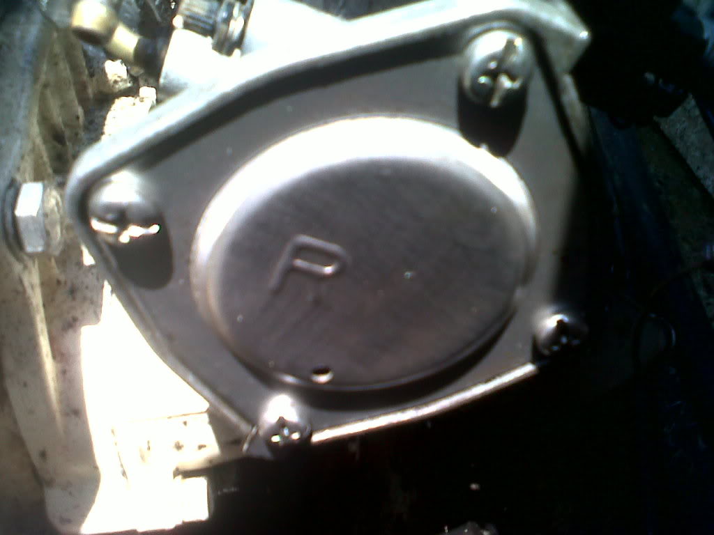

Ran a compression test, front carb was 145, rear was 139 first time, 140 2nd time, so I am ok with those numbers. ANOTHER problem that I am running into is that I think I might have 2 of the same carb, instead of one mag and one prop carb. They both look the exact same, both have a 'R' stamped in the rear side cover, and there is a hose coming off the block that looks like it goes directly to the carb, but has nowhere to hook up. I'm gonna add pics in a minute.
Front:
Back carb side plate:
Don't know if you can see it on this one, but the same 'R' is stamped in the cover:
The hose that goes to nowhere. Any idea where this should go? From what I can see on other carbs, this hooks directly to the side of the carb where that blue cover is, and should have a totally different side cover on it.

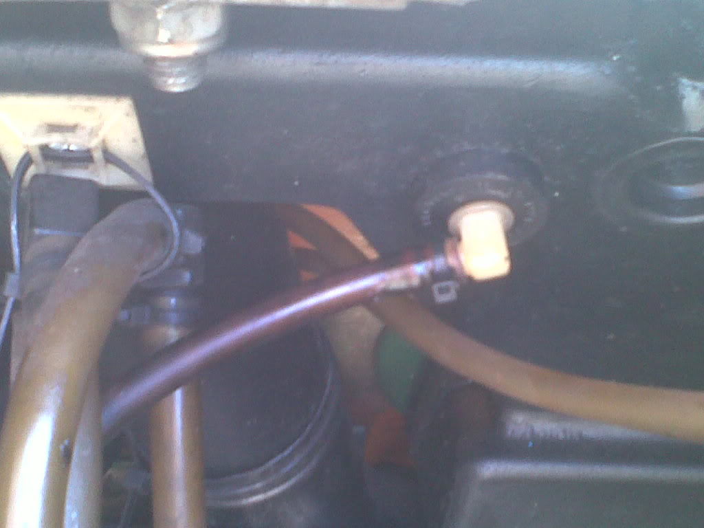

Also, safe to say that this is the battery vent? It has a long hose that goes to nowhere, but is long enough to make it to the battery tray.
