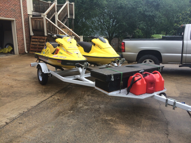

Do it! Adding a tool box, can rack and walk boards has made all the difference in how my trailer functions.

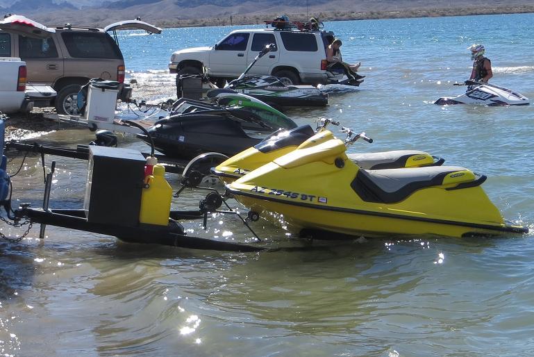

My trailer has the box and gas can rack built in. The gas can rack would be easy to replicate with some angle iron and a length of metal rod that goes through the handles on the cans.

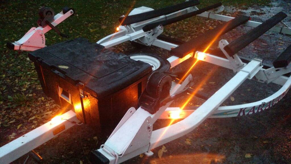

Got an older karavan two place. But with my big gtx the box is almost completely submerged. It tows wonderfully but I can't keep anything in the box at all.
Post a few pictures of your set up, maybe we can rearrange things and help with the box issue.

The box is junk. It needs to be replaced with a better one if I even replace it at all. One latch is gone as well as a hinge pin on the same side. It's bolted to the frame where it "y"s for stability. I'd rather have a platform to stand on in place of the box. I can keep anything I would put in the box in my truck or the SeaDoo itself. And the box is just always in the way.
I do need to get a new winch for my side. It needs a center board and the bunks could probably stand to be replaced at some point as well.

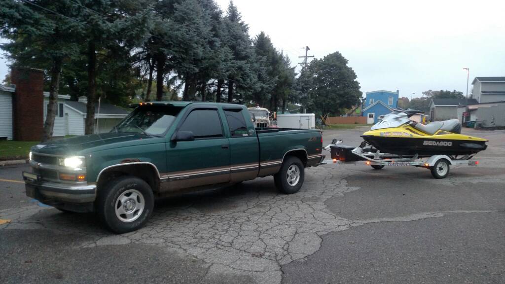

Got new load c 4.80-12 tires as the ones that were on it were worn and cracking. Also put a new coupler on with grade 8 bolts, shortened up the chains so they didn't have to have a knot in them and new grade 8 bolts there as well. New 1100lb crank and strap on my side and the waverunner got the good strap from my side. Also moved the license plate to the fender to prevent damage to it and added a light for it as well. This year I may end up painting it black. The box will be coming off. Not sure if it will be replaced or not. If I do replace it I will be using a sealed aluminum diamond plate locking unit
